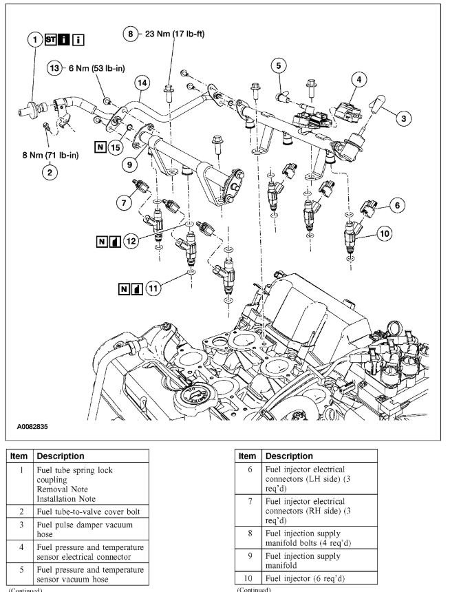

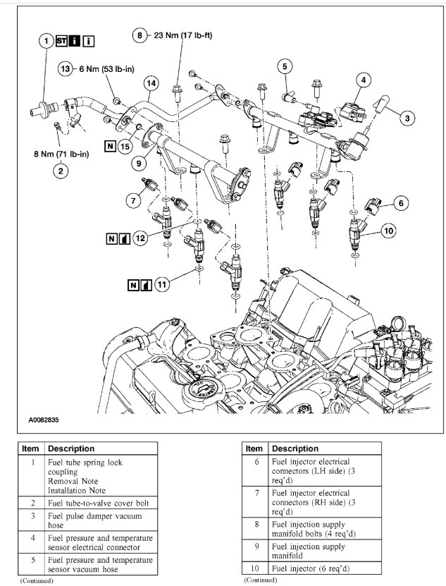

Here's a blown up diagram of the fuel rail and all of its components. Check out the diagrams (Below). Please let us know if you need anything else to get the problem fixed.

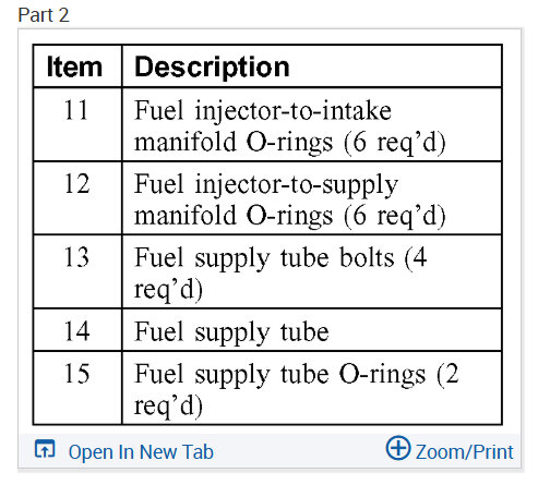

What is the part number to number 14 on this image?

That is called a fuel rail supply line. They sell the rail together.
Fuel Rail part# 1L2Z9D280ED $208.33
