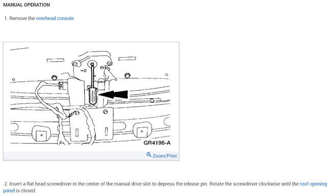

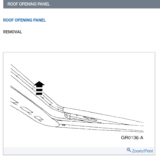

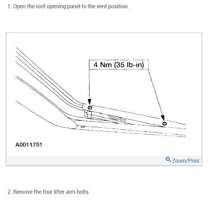

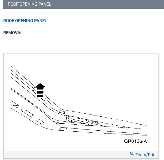

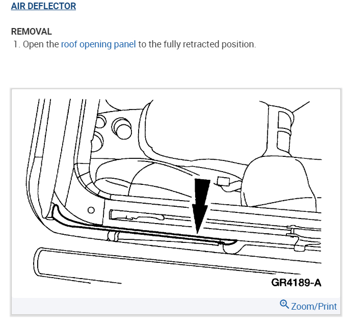

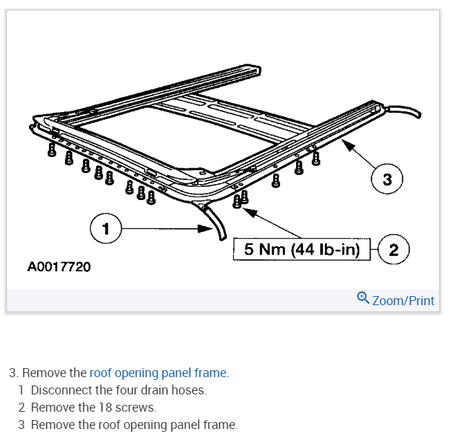

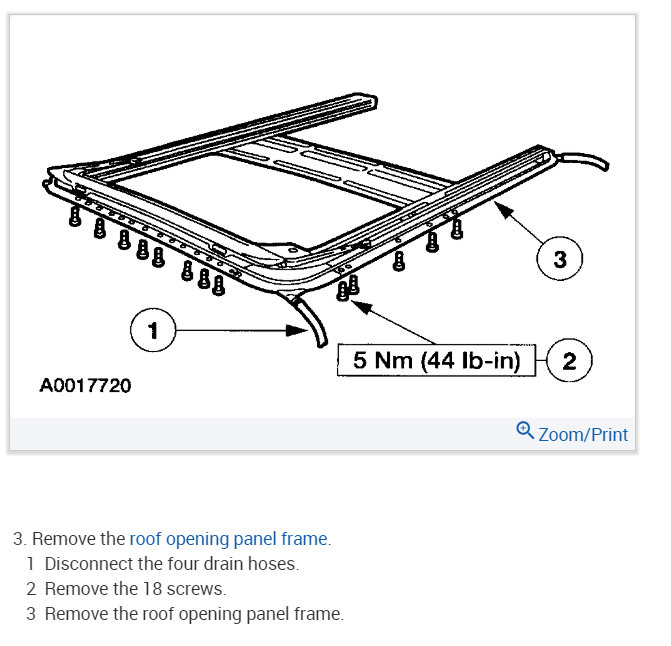

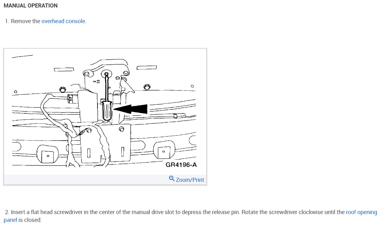

Insert a flat head screwdriver in the center of the manual drive slot to depress the release pin. Rotate the screwdriver clockwise until the roof opening panel is closed.
Inserting flat head screwdriver in center of manual drive slot to depress release pin.

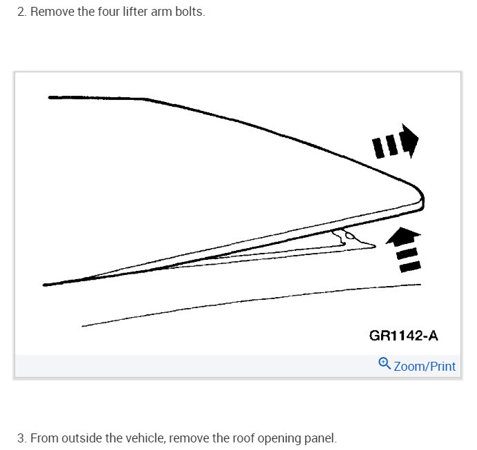

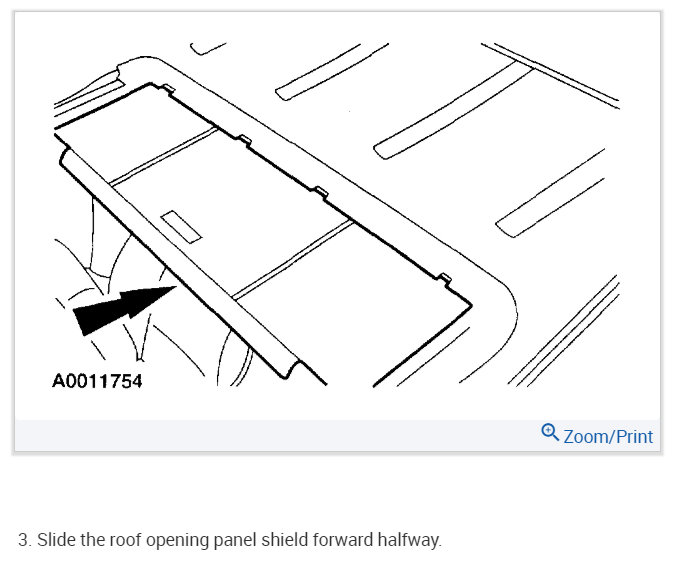

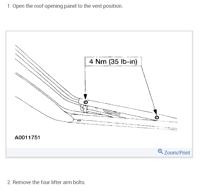

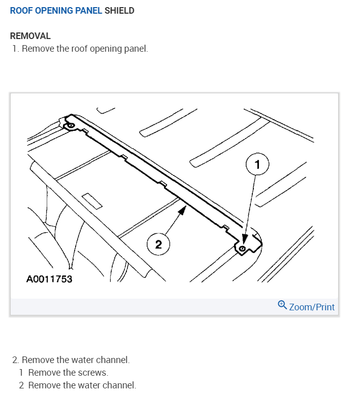

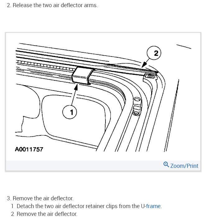

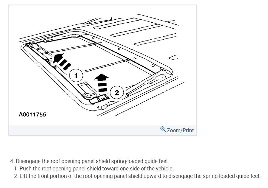

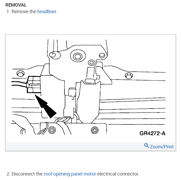

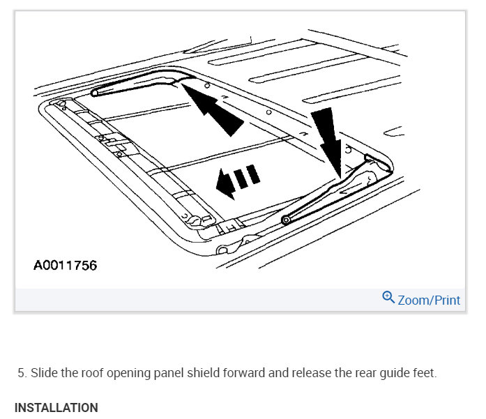

Here are sunroof repair guides below. Check out the diagrams (below). Please let us know if you need anything else to get the problem fixed.
