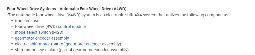

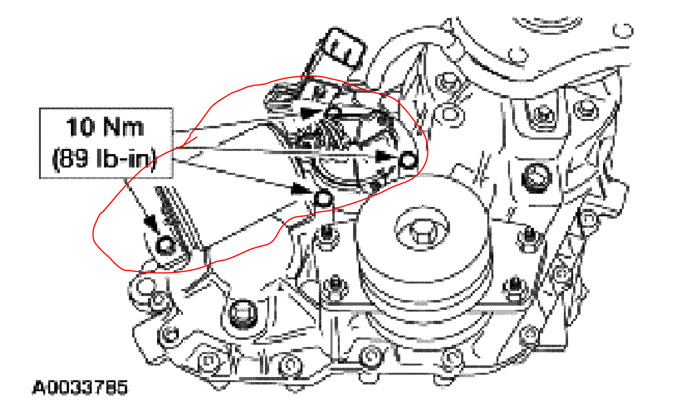

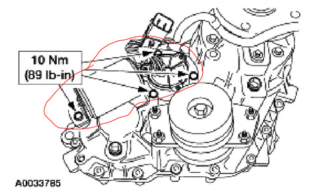

When you say control module, are you referring to the transfer case shift motor? See pic 1.
Also, I need to know if this vehicle has the automatic 4wd or if it is an AWD vehicle.
Dec 21, 2020 at 9:53 AM (Merged)

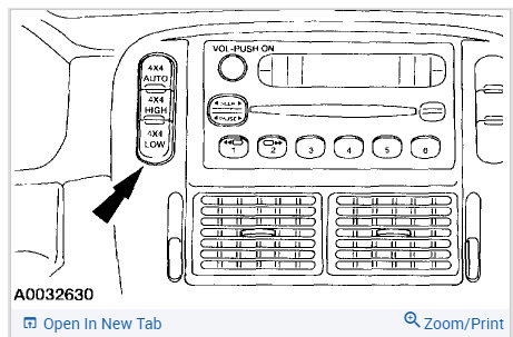

Can you confirm for me that you have the automatic 4 wheel drive system that is attached? The picture of the buttons is the second image. The Eddie Bauer should have this unit but I just want to make sure before we proceed because I suspect you have an issue with the encoder assembly, but we need to make sure we are dealing with how your vehicle is equipped.
Thanks
COMMANDER1
Yes, it has automatic four-wheel drive, four-wheel drive high, four-wheel drive low and the buttons are as in photo, they light up but when pushing the buttons the dashboard indicator light that says hi 4x4 or low 4x4 does not appear when pushing the button, I changed out the transfer case control module brand new but still nothing. the way it feels as I drive it's in four-wheel drive. unknown if it's low or high but winter is coming on and we will be snowing soon. I need to try to figure this out. I appreciate any information you can help me with.

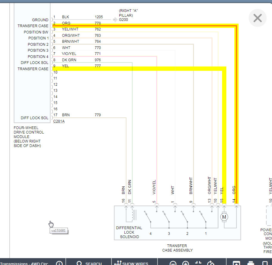

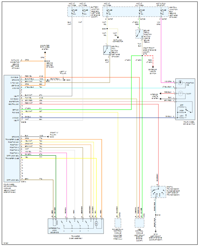

We need to go to the transfer case motor as shown in the wiring diagrams and press the 4 high switch and see if there is voltage to the motor. Then press Low. Then Auto. Is there voltage on the motor when pressing any of these buttons? If so, you need a motor as it is most likely failed if you cannot hear it moving.
Basically this motor just has power put to one side or the other depending on what button is pressed. The module you replaced is the power and ground for it as it just reverses the polarity when moving one way or the other.
Let us know this and we can go from there.

I would check for power at the 4WD control module. You must select the 4WD on to check for power. The pins should be pin 8 and pin 17. These are the BK/WH and WH wires. This should be your power and ground pins. If do not have power, then find where you are loosing the ground or power.
If you have power to the conrol module, then there are a series of test that will need to be run to isolate the problem.
