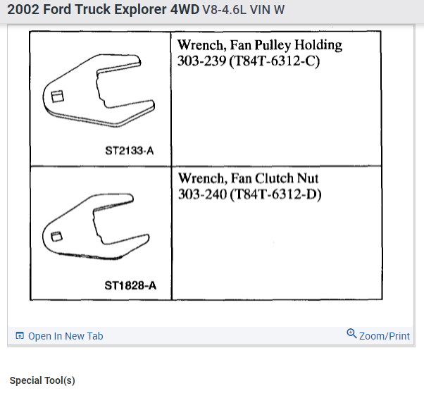

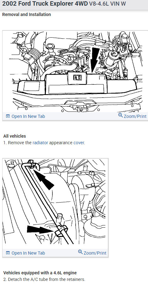

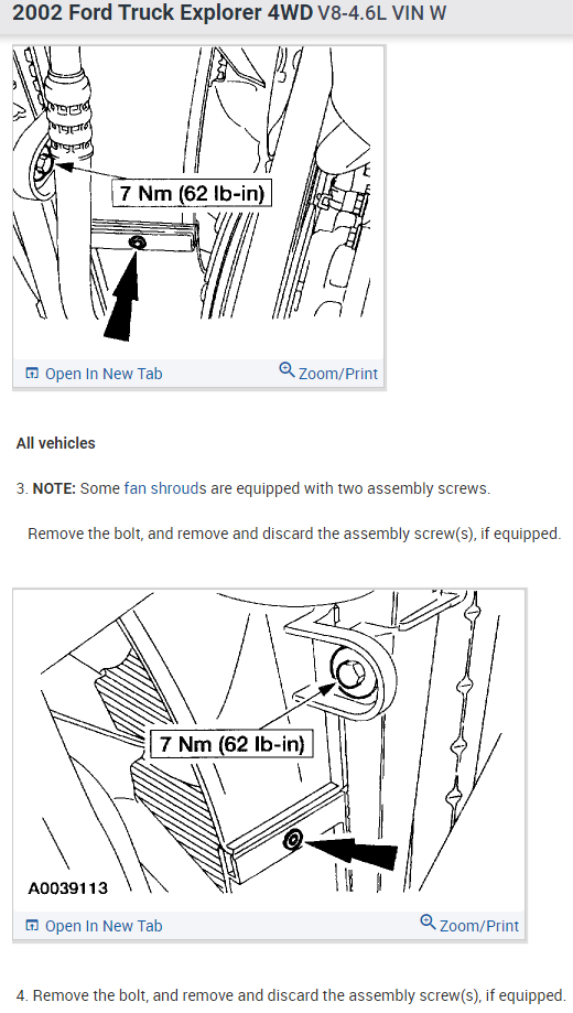

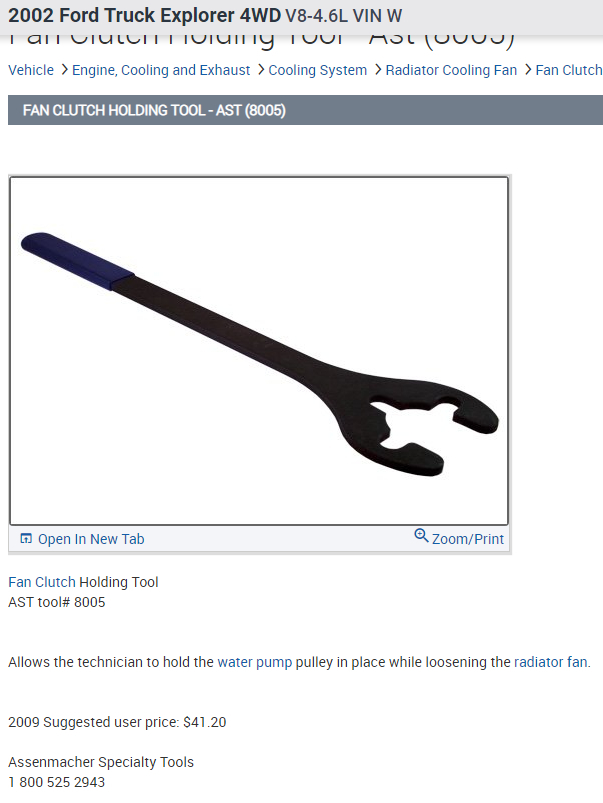

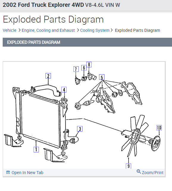

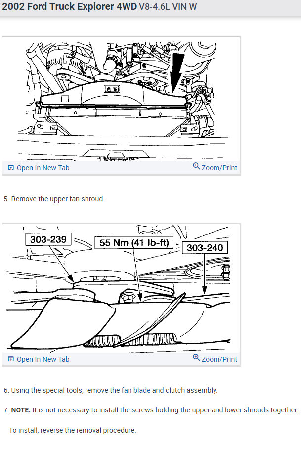

A faulty fan clutch would keep the fan engaged for extended period of time or may not engage at all.
To remove the fan clutch you will need a special fan clutch tool.
These tools are readily available at your local auto parts stores that you can "rent" to get the job done.
Here is a helpful article of how to change fan clutch:
https://www.2carpros.com/articles/fan-clutch-removal
Check out this video for some helpful tips:
https://youtu.be/N_-MLVlBHk8
I have attached the replacement procedure for your vehicle.
