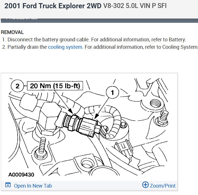

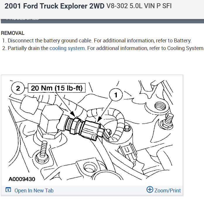

You can see if the coolant sensor is working by seeing the reading on the scanner, if there is a reading the cluster is bad and needs replacement. To be sure you have the correct sensor this is the location. Check out the images (below). Please let us know what happens.
