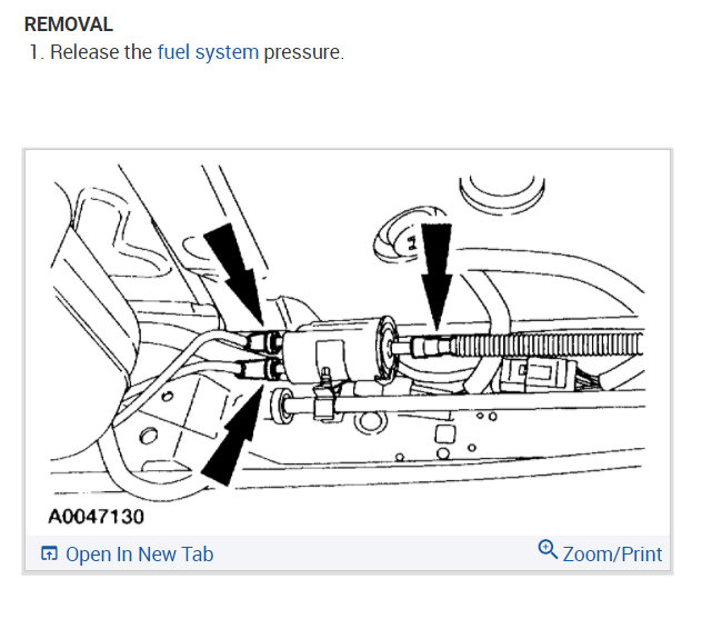

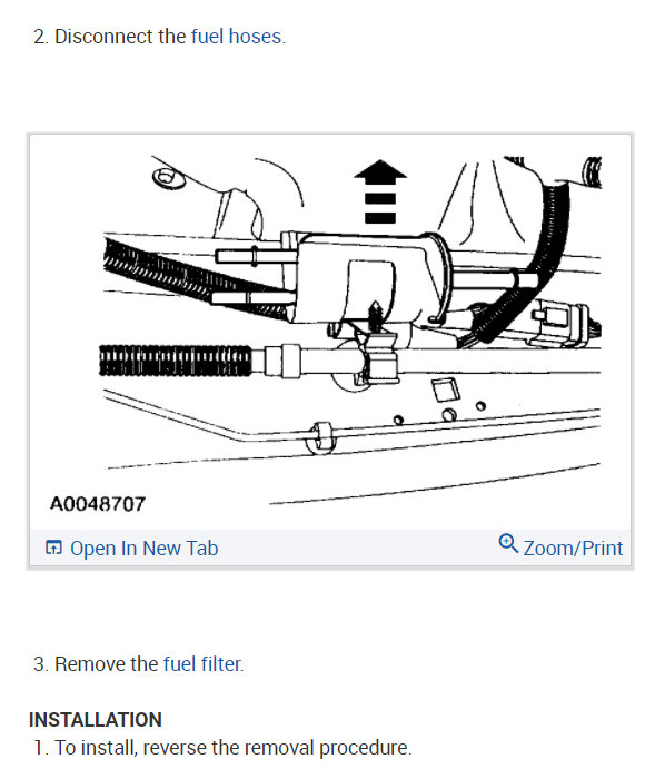

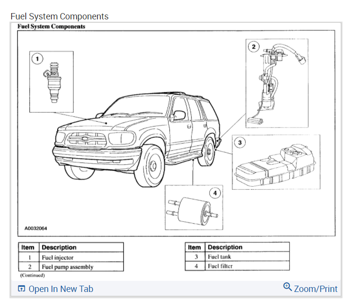

Every once in awhile, my car will not start. It turns over, but then just slowly stalls out and then dies. Usually though, I can try starting it a few minutes later and it will start. From what I've been told (by friends that have had problems like this one) it could possibly be my fuel filter. I know that part is inexpensive, but I have no idea how to change it myself. My roommate has changed one on his car before, but seeing as that's a different model, I wanted to find out for sure how to do it for my car.
