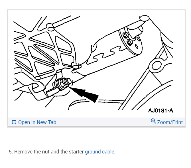

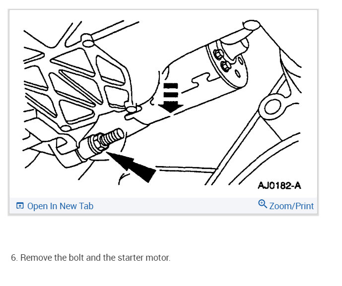

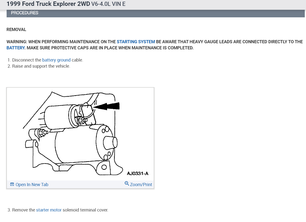

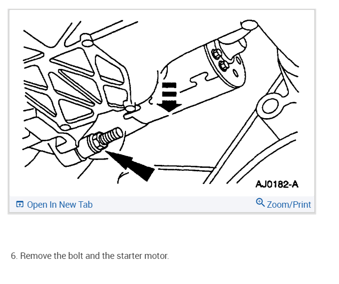

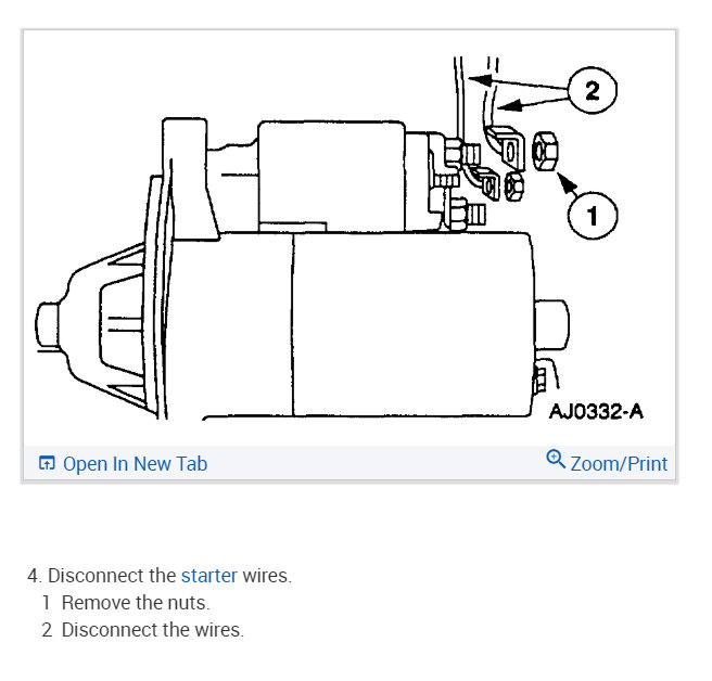

Disconnect negative battery cable. Raise vehicle. Disconnect battery cable from starter. Disconnect starter solenoid wiring. Remove starter mounting bolts or nuts. Remove starter from vehicle.

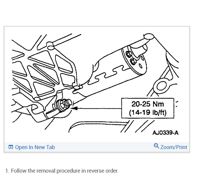

Position starter assembly onto flywheel housing. Start bolts. Hold starter against mounting surface, fully inserted into pilot hole. Tighten bolts or nuts to specification.

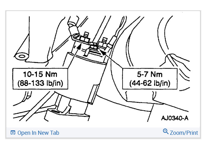

Connect battery cable and solenoid wiring to starter. Tighten to specification. Lower vehicle. Connect negative battery cable. Check starter operation.
