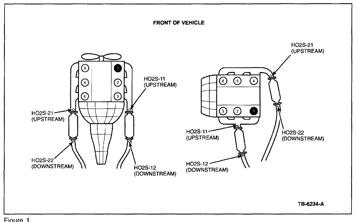

Is the 02 sensor bank 2 down stream located on the right or left side?
Sep 19, 2018 at 12:20 PM (Merged)
RASMATAZ
  • 75,992 POSTS
I have attached a diagram below of the Oxygen Sensor locations for you truck.
Let us know if you need anything else.

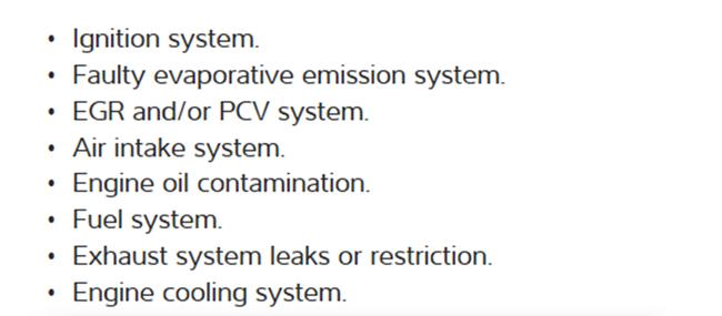

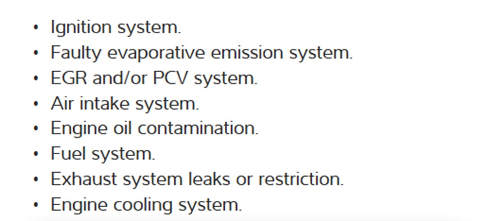

Was running fine about a week ago, with gas slowly going away, but now it came with codes p0171, p0302, p1131 and my gas is going by incredibly fast.
HMAC300
  • 48,601 POSTS
171 is running lean and 302 is misfire on number two cylinder both of these can be caused by low fuel pressure. 1131 can be caused by the items in picture which includes fuel pressure which should be 30-45 psi. Auto parts rent gauge. If pressure is okay then I would suggest having a pro diagnose this as it is extremely hard to find cause of misfires.
