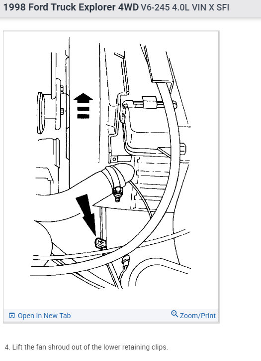

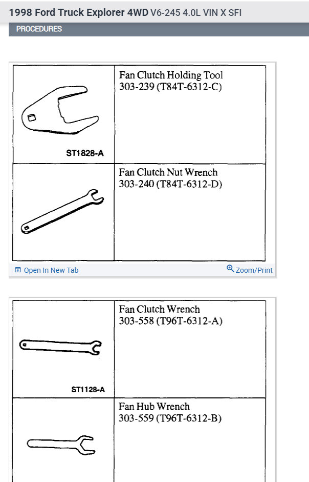

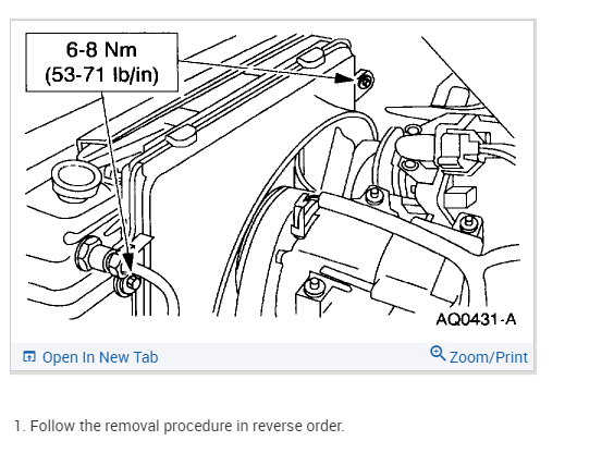

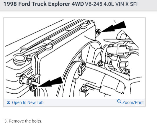

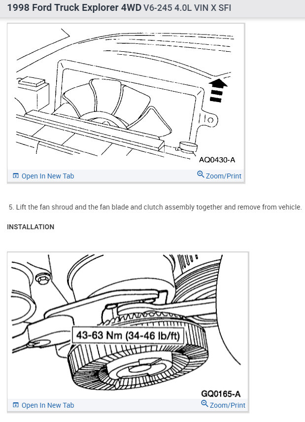

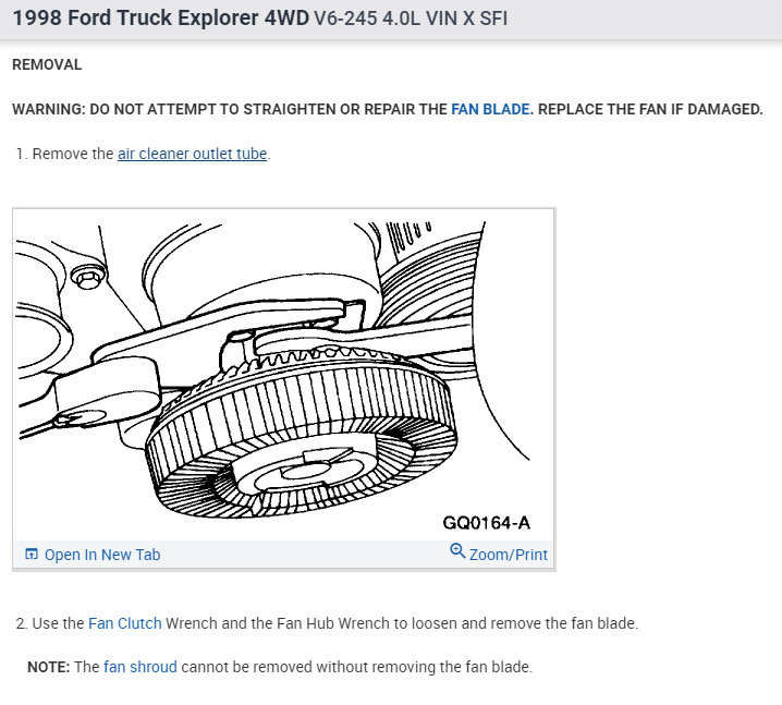

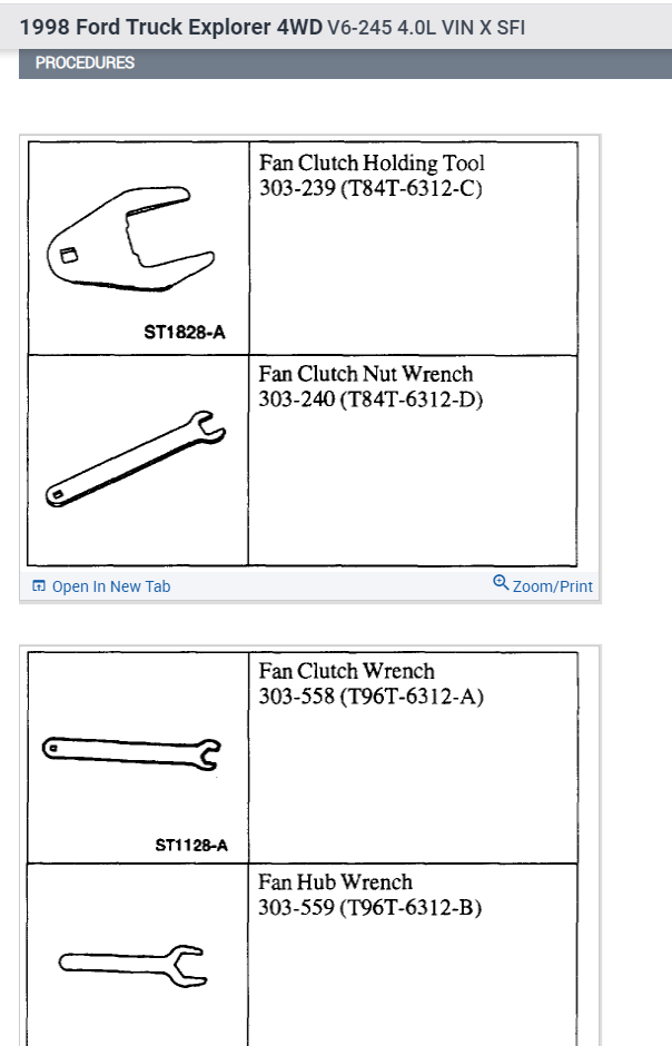

In order to replace the fan clutch you will need to use a fan clutch tool.
Here is a helpful guide:
https://www.2carpros.com/articles/fan-clutch-removal
I have attached diagrams for the replacement procedure below.
