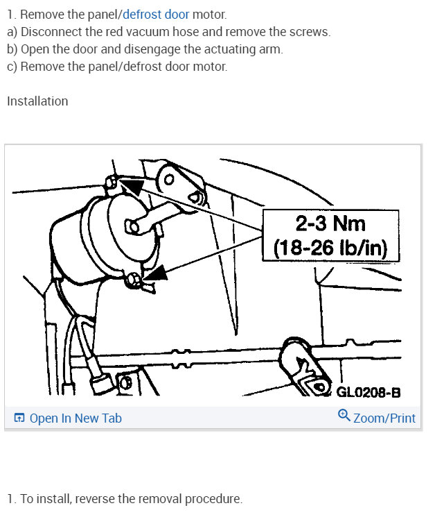

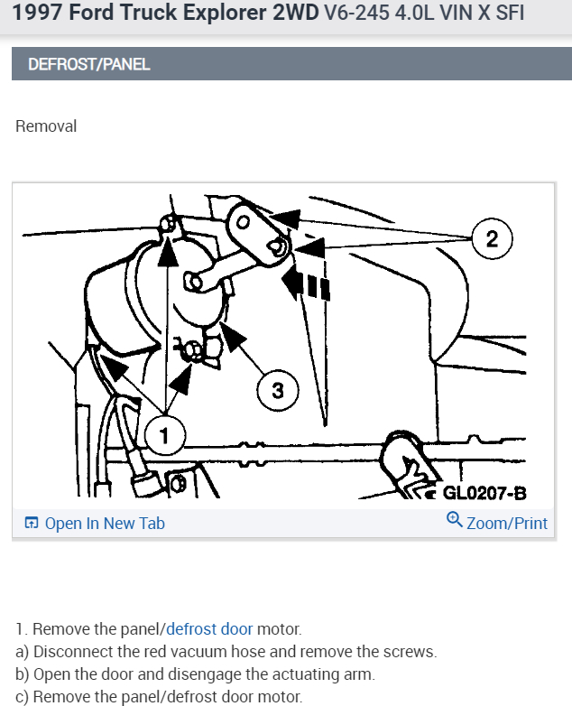

It sounds like you have a vacuum blend door actuator that has gone out but we should check for vacuum for it. With the engine run move the HVAC control to defrost and remove the vacuum line, it should have vacuum. Here is the location. Check out the images (Below). Please let us know what happens.
