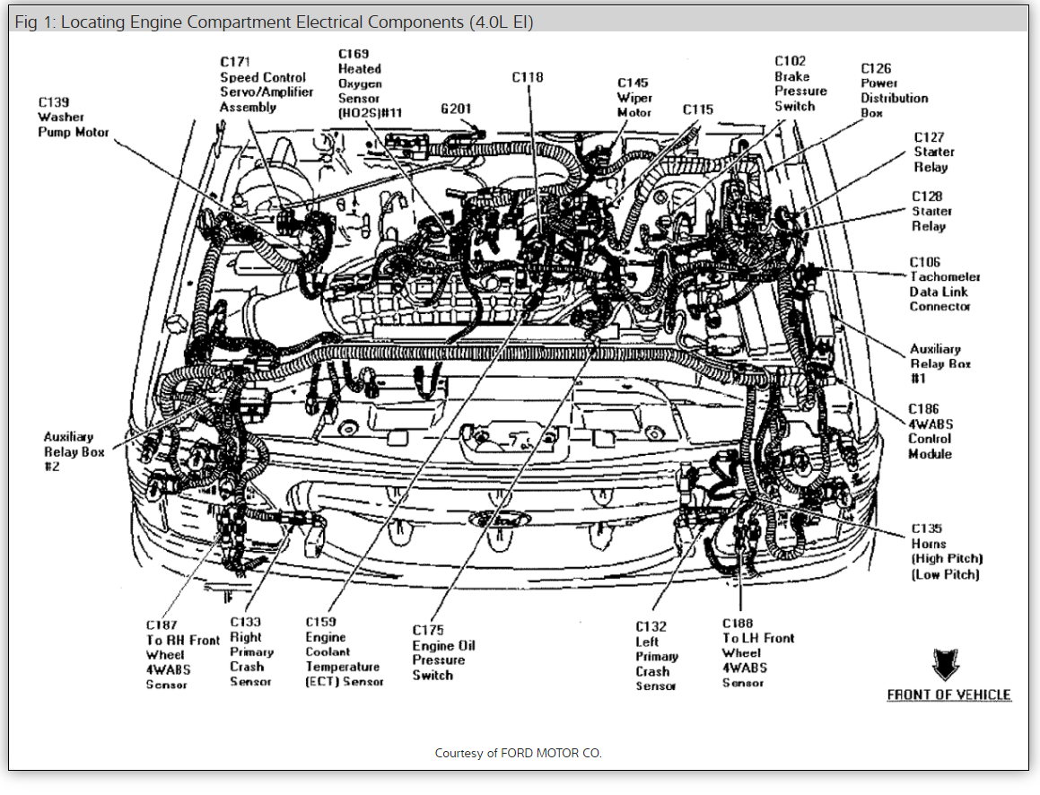

My Explorer blows my #2 fuse upon start up ( as soon as the ignition is turned). The first time if blew, i replaced the fuse and the car ran for about 3 weeks. No the car won't turn over at all with the new fuse and blows that fuse when the ignition is turned. My mechanic is having a hard time figuring out how to trace the problem. Just a few days before the car started blew the fuse when starting the check engine light came on. Any assistance would be helpful.
Apr 11, 2009 at 9:07 AM
RACEFAN966
  • 5,029 POSTS

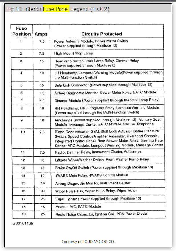

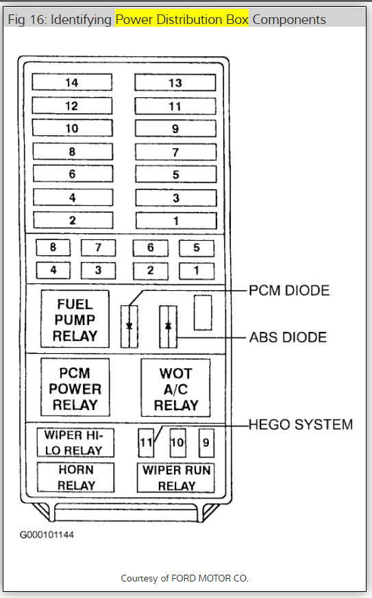

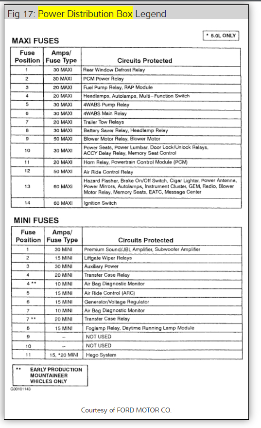

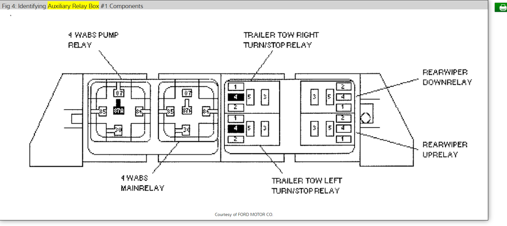

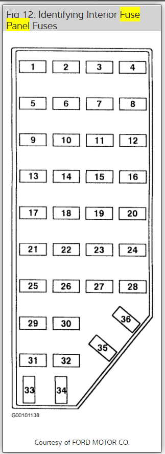

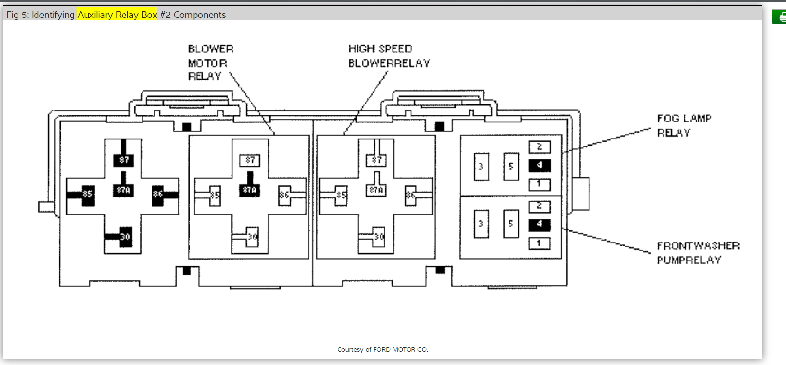

Is this fuse in the power distribution block under the hood? If so then there is 2 number 2 fuses so is it the 15 amp one or the 30 amp one. It sounds like you have an ignition coil that is shorted I would replace it and try it again. Here is the fuse panel diagrams to help you see whats going on.
here is a video of the coil being replaced on a similar car.
https://youtu.be/iDgXwKA-IIc
Check out the diagrams (Below). Please let us know what happens.
Cheers
Apr 11, 2009 at 9:28 AM
MICHDLB
Yes the fuse that is blowing is in the box located under the hood. So I replaced the ignition coil and the problem has not happened again. I love this site!
