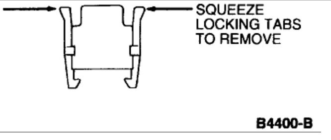

Removing Ignition Wires At Coil Pack
REMOVAL

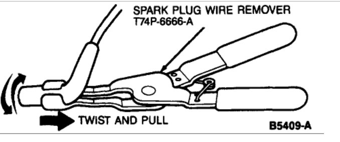

Disconnect ignition wire from spark plug by grasping the boot and twisting slightly in both directions to free it.
Disconnect the ignition wire from the ignition coil by squeezing the locking tabs and twisting while pulling upward.
