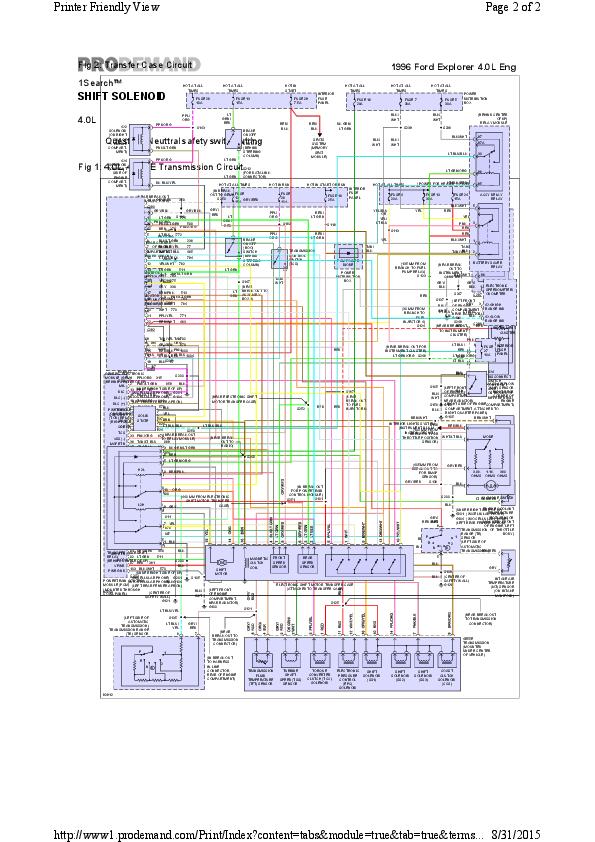

I've attached the transmission and transfer case wiring schematics in hopes they will help.
