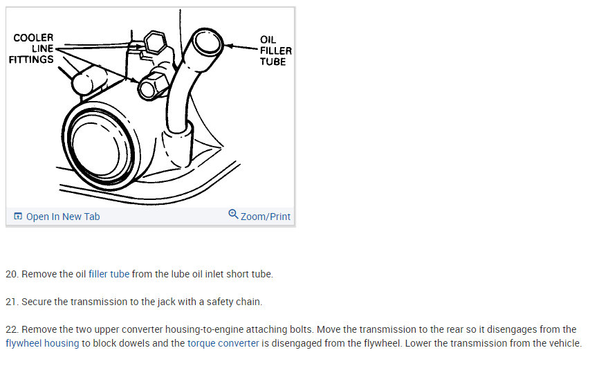

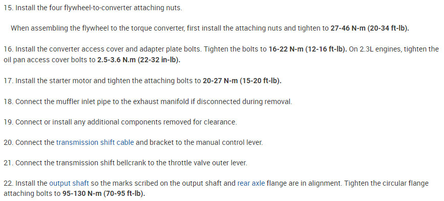

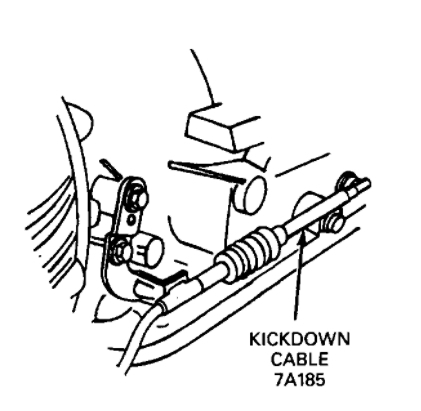

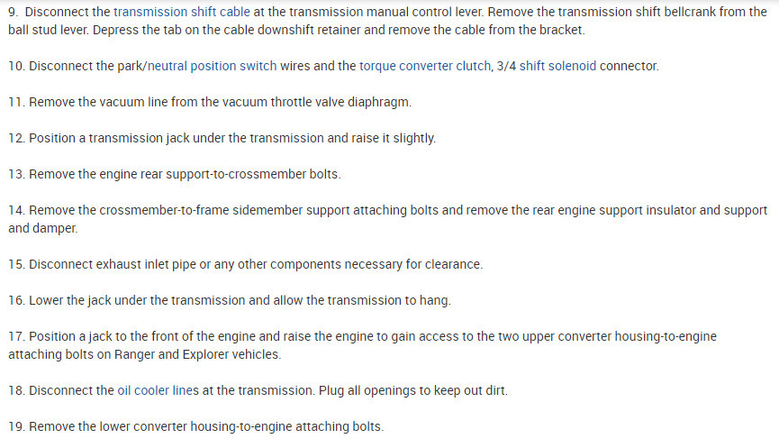

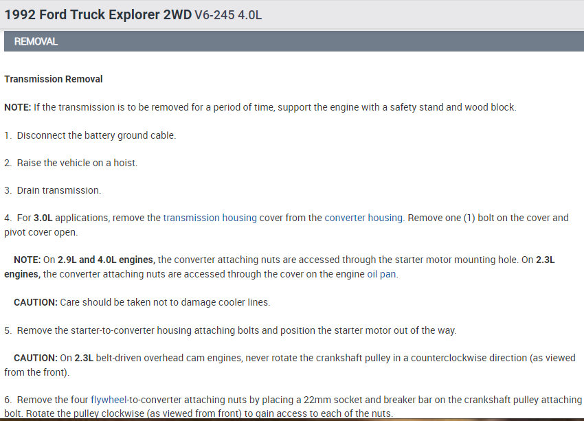

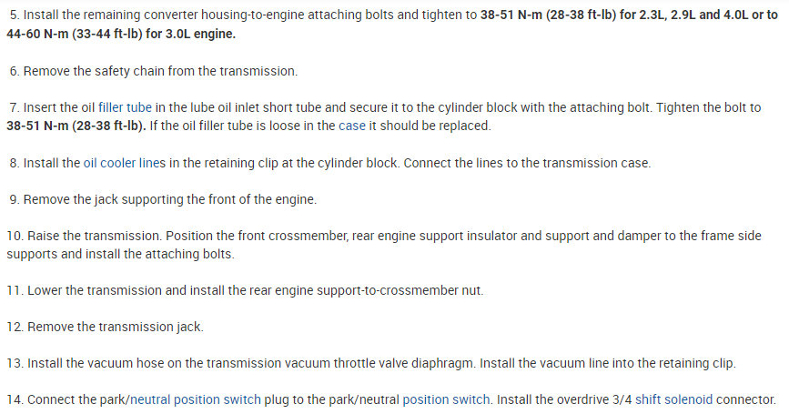

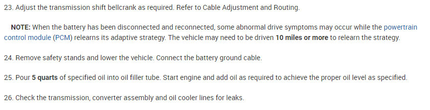

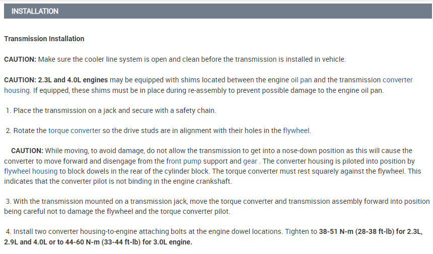

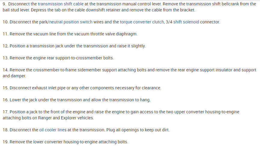

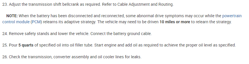

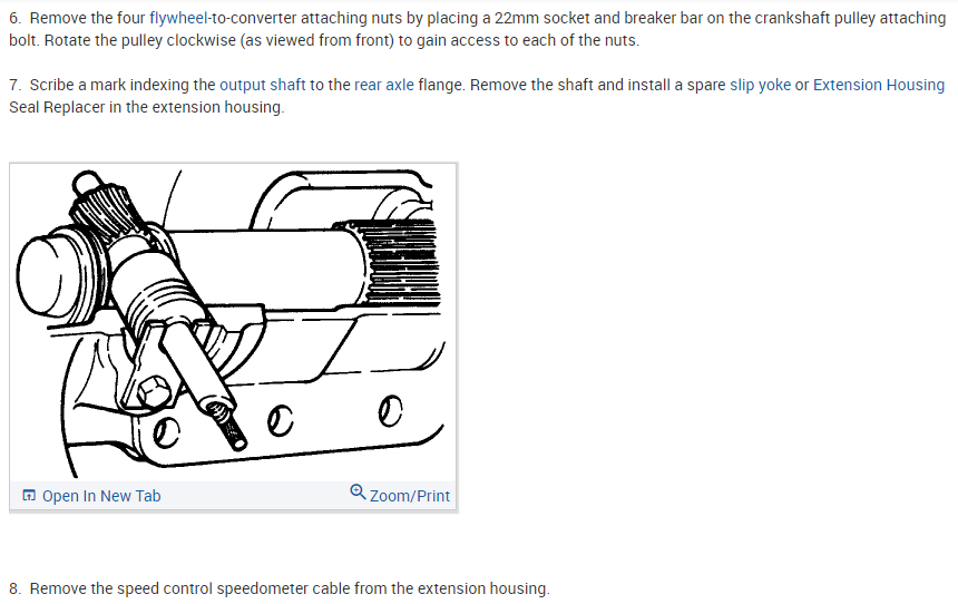

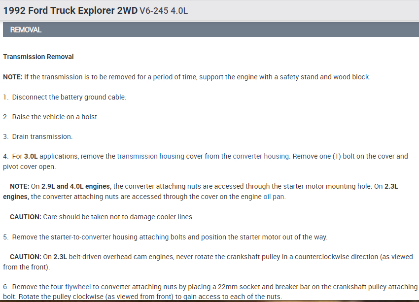

I've attached picture steps below on how to remove and replace the automatic transmission on your Explorer. Hope this helps and thanks for using 2CarPros.
