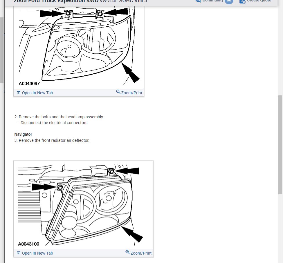

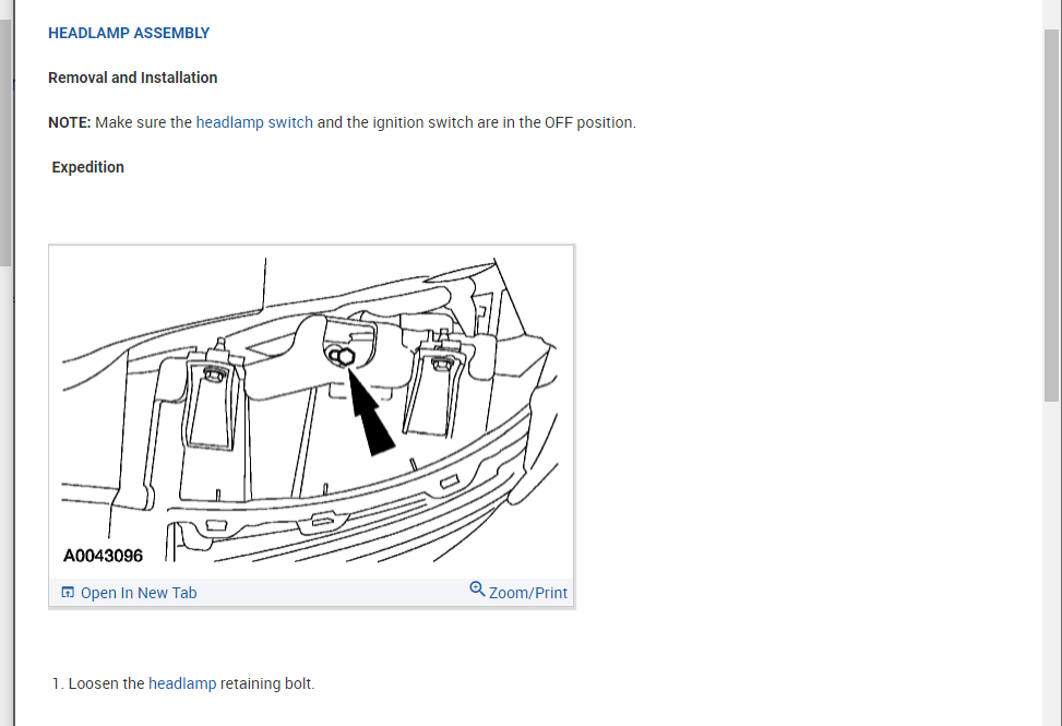

I've followed direction in owners manual, have removed to back screws & loosened verticle screw, but can only move the headlamp assembly about 1/4" forward. Cannot get it to move all the way out to reach connection on back of bulb

More than likely you are missing a bolt but here are a couple guides that will help with replacing this assembly:
https://www.2carpros.com/articles/headlight-lens-replacement
https://www.youtube.com/watch?v=ITW8lq7zO80

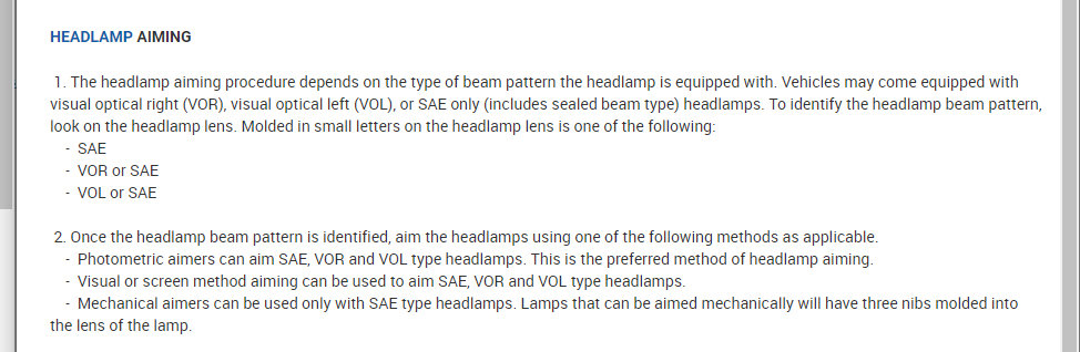

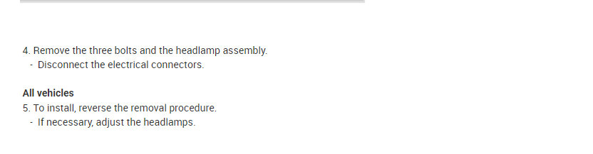

Below you will find the process from the manual that will help with replacing this assembly. Please run through this material and let me know if you have other questions.
