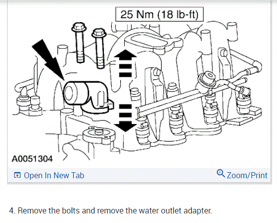

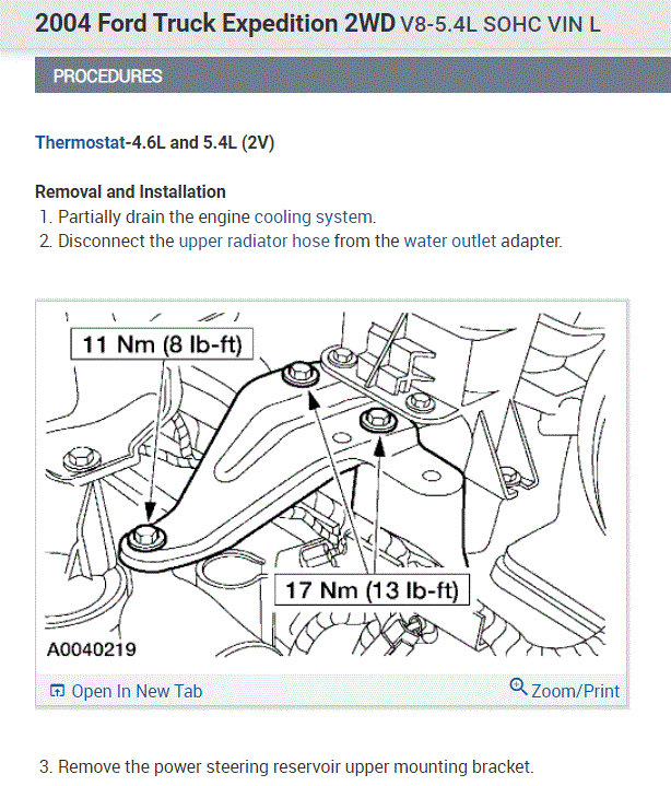

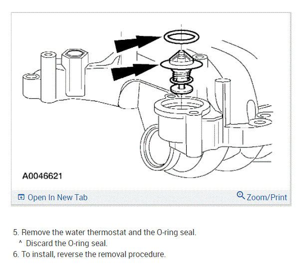

If you look at the attachments below, they provide the directions and pics specific to this vehicle for replacement.
I hope this helps. Let me know if you have additional questions.
See pics below.
