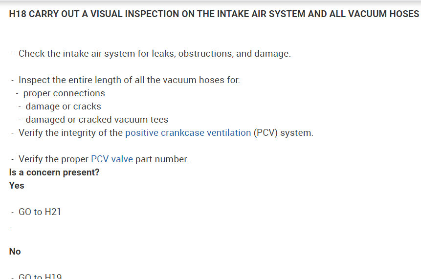

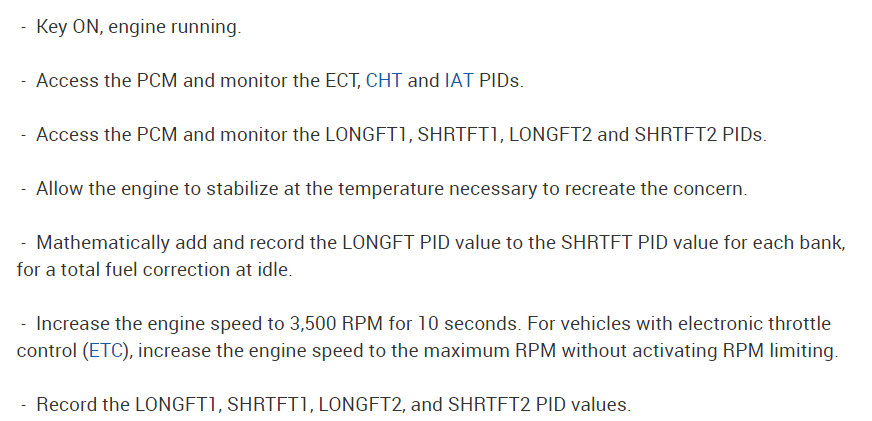

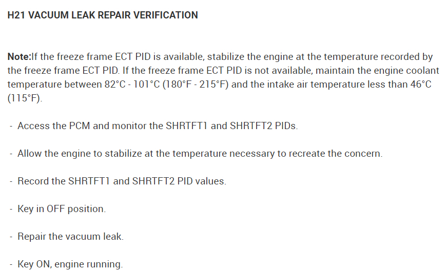

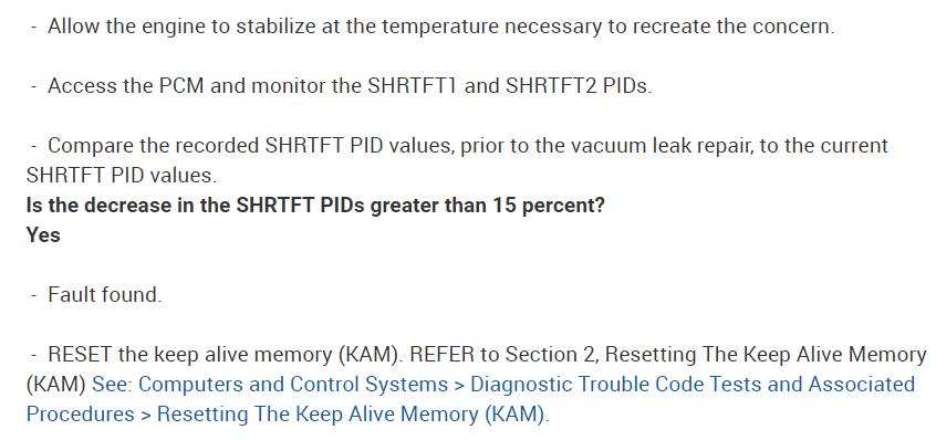

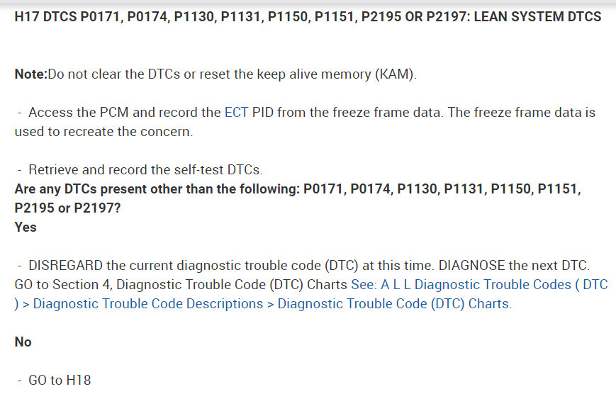

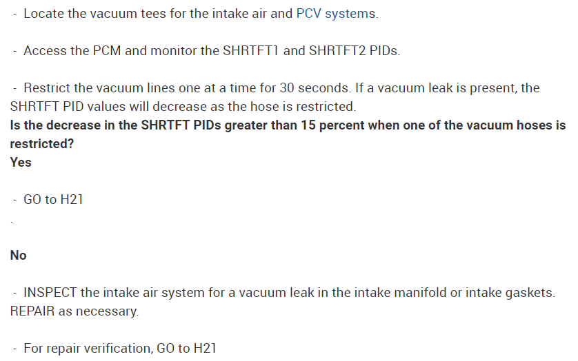

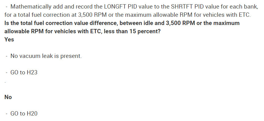

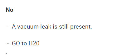

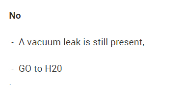

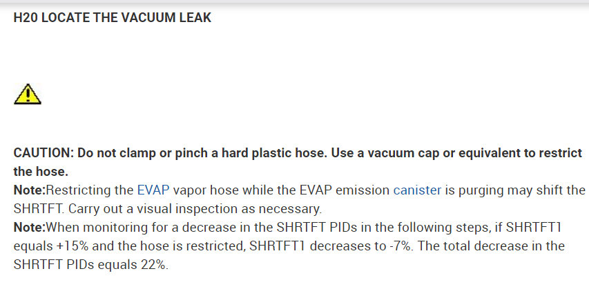

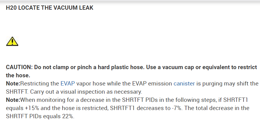

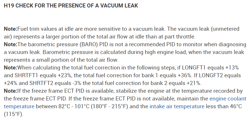

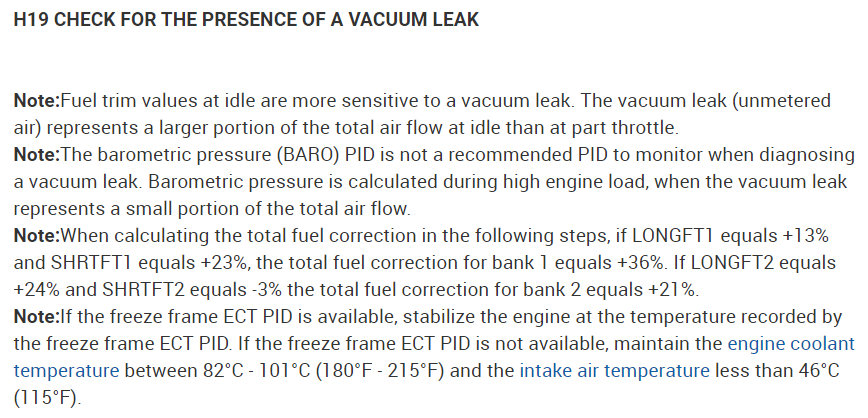

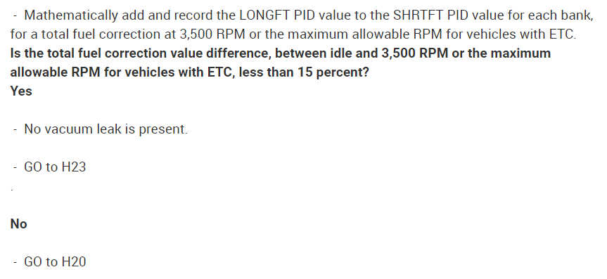

Those 2 code are showing that both bank 1 and bank 2 are too lean. This is usually caused by a vacuum leak or some other type of air leak allowing excessive unmetered air into the engine. Here is a tutorial showing how to check for a vacuum leak:
I've attached below picture diagnostic steps for your vehicle. Hope this helps and thanks for using 2CarPros.
