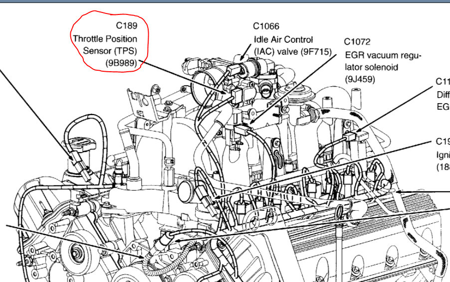

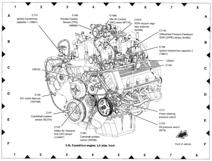

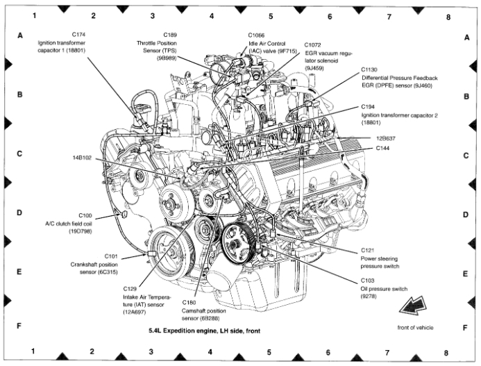

where is the TPS located on this car and how easy is it to replace?
Apr 11, 2009 at 9:52 AM
DANNY L
CERTIFIED EXPERT
5,648 POSTS

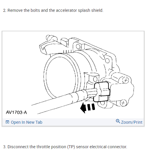

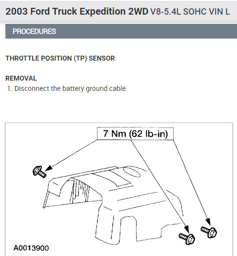

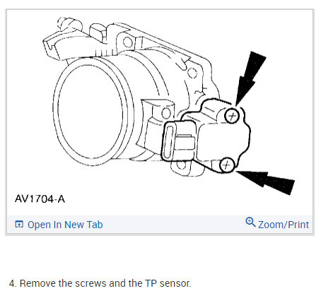

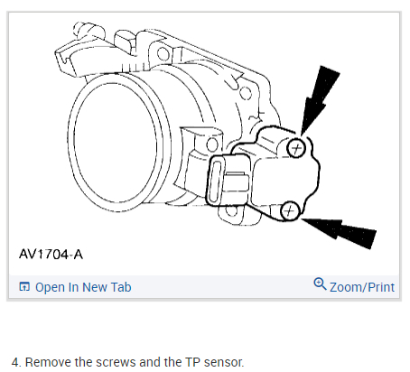

Hello, I'm Danny.
Here is the information you requested. The repair is fairly simple. I've attached picture steps below including the location of the throttle position sensor I've circled in red and how to replace. Hope this helps and thanks for using 2CarPros.
