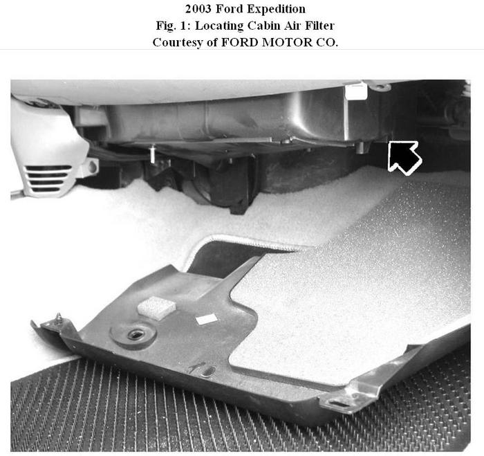

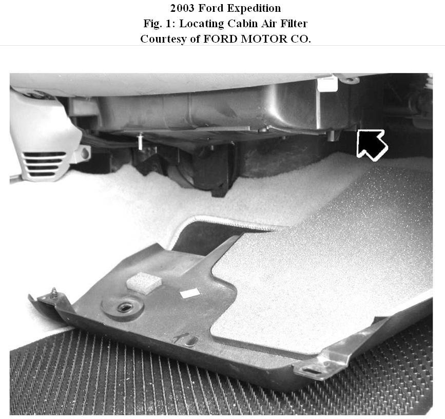

from the book:
Note: The air distribution system of this vehicle cannot be equipped with a cabin air filter.
Cabin air filter is available as an optional dealer-installed kit. Cabin air filter installation instructions are included with the kit. If a filter is already installed, it is located under the right side of the instrument panel in the HVAC housing. Trim panel may have to be removed to gain access to filter

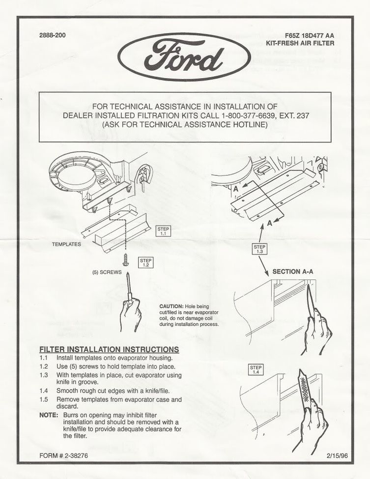

The 2003 did not have an HVAC box that had a factory filter. There is a kit that could be installed on the first generation trucks up to 2002. When Ford did the redesign for the 2003 the new HVAC box the blower motor was relocated and there is no provision in the new system for a filter.
The attached is the filter kit instruction, for it you remove the trim panel under the glove box and the blower motor is there. The filter is located next to it.
On the 2003 the blower motor is hidden behind the passenger side kick panel trim cover.

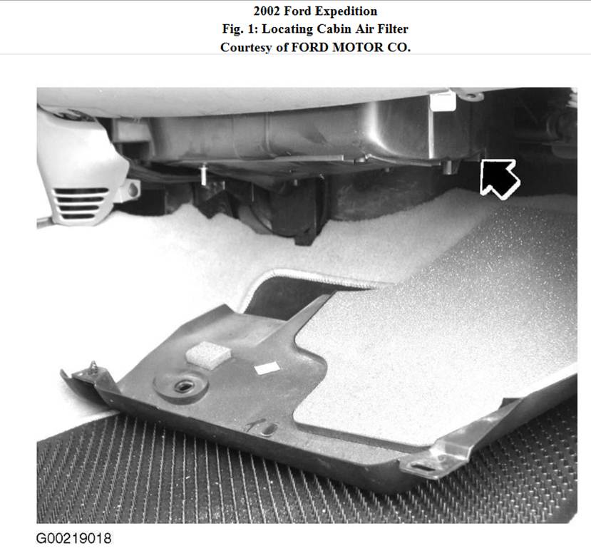

The cabin filter was an option in these vehicles. If your vehicle has it, the filter will be located on the passenger side under the dash. Below you will find a guide for replacing the filter as well as a diagram of the location
https://www.2carpros.com/articles/how-to-change-an-air-cabin-filter
A cabin air filter is available as a dealer-installed accessory for the air distribution system of this vehicle. Instructions for installing and servicing the cabin air filter are included with the filter when purchased

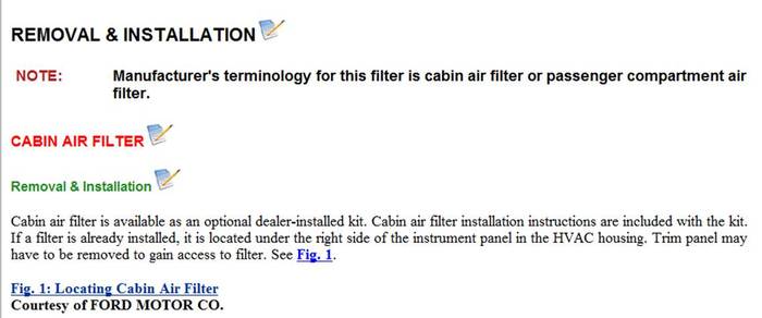

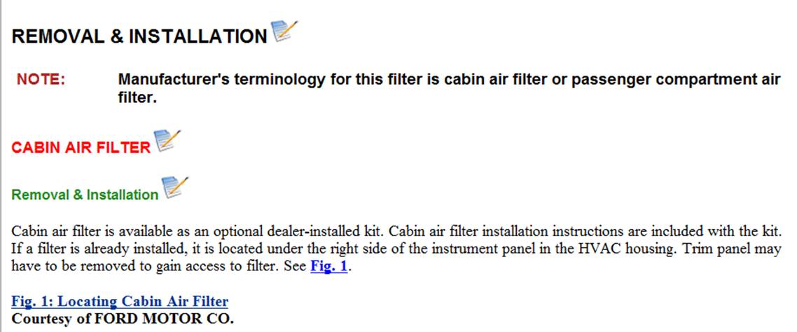

CABIN AIR FILTER
Cabin air filter is available as an optional dealer-installed kit. Cabin air filter installation instructions are included with the kit. If a filter is already installed, it is located under the right side of the instrument panel in the HVAC housing. Trim panel may have to be removed to gain access to filter. See Fig. 1.
