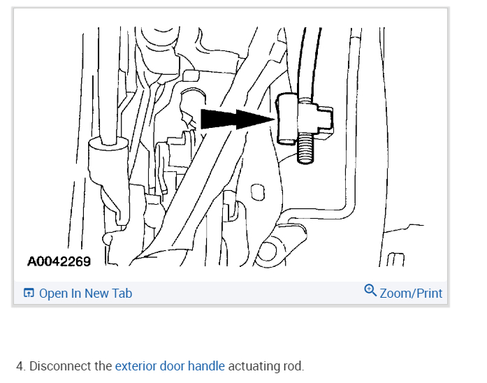

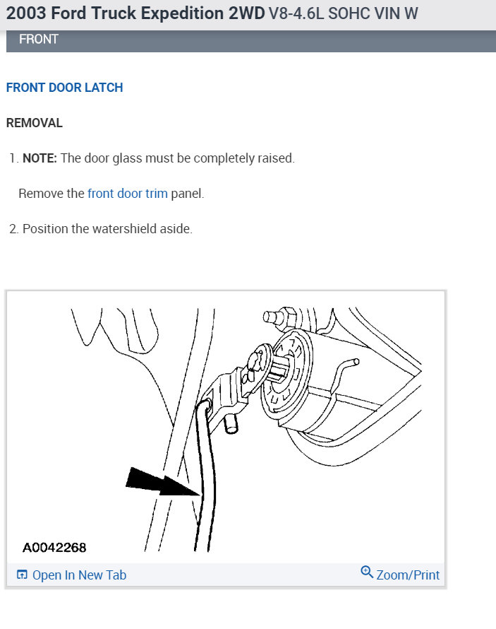

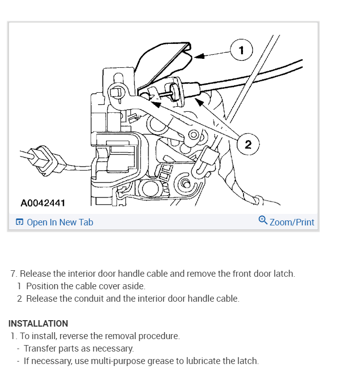

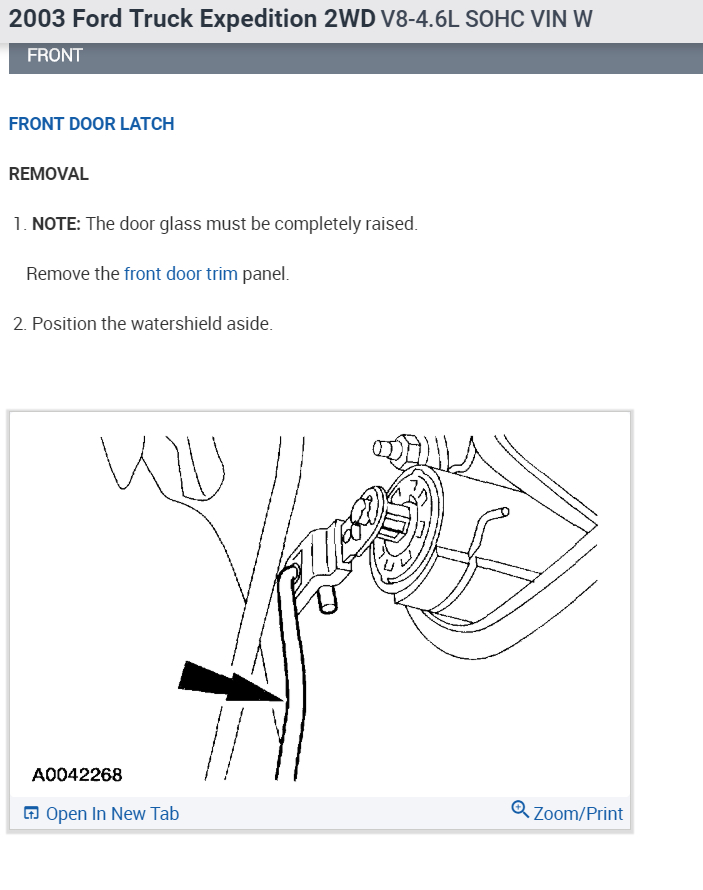

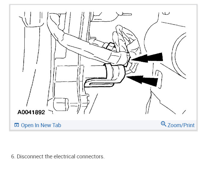

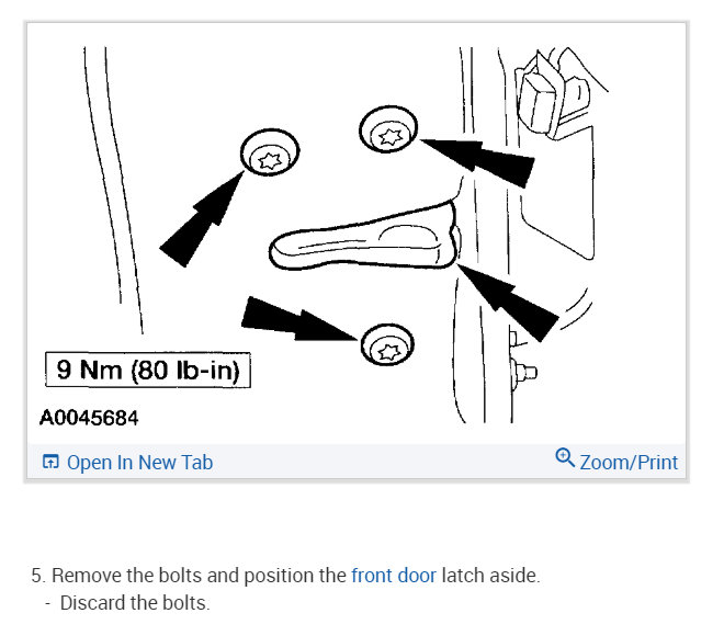

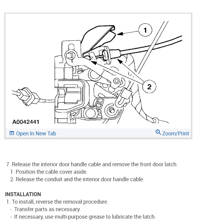

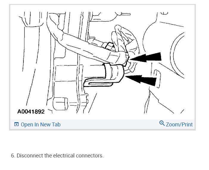

The switch is part of the latch assembly on your vehicle. You need to remove the door panel to access it. At that point you can check to see if the switch is bad or dirty. Here are diagrams below to help you change it out. Check out the diagrams (Below). Please let us know what you find.
