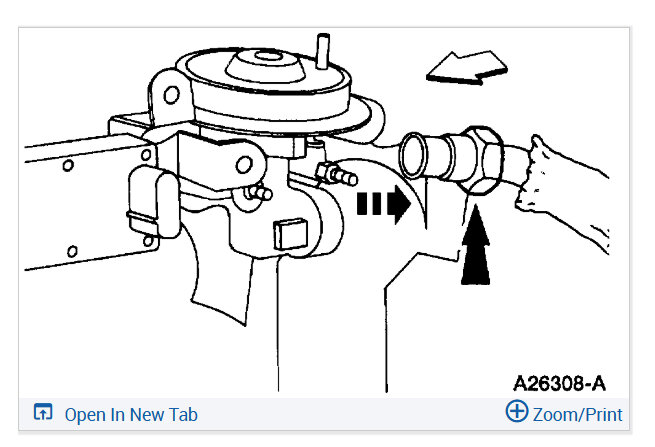

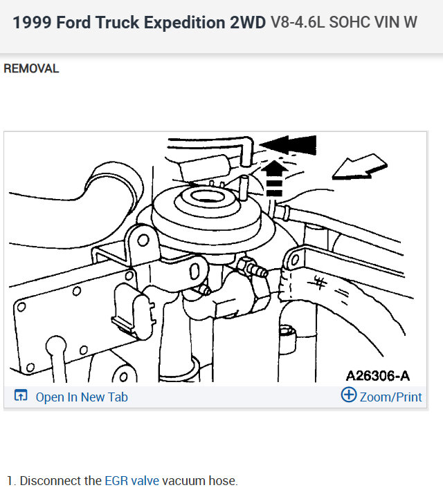

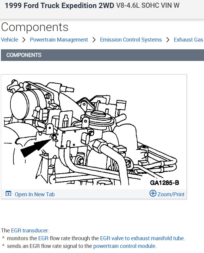

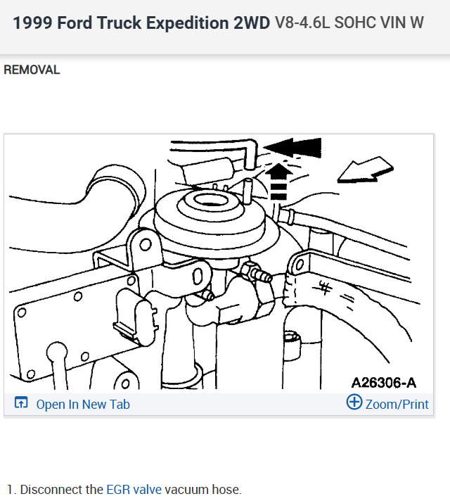

where is the egr valve located?
Jan 1, 2009 at 11:25 AM
DAVE H
  • 13,384 POSTS
EGR Vacuum Regulator Solenoid (4.6L)On left side of engine. EGR Vacuum Regulator Solenoid (5.4L)On left side of engine.
https://www.2carpros.com/forum/automotive_pictures/266999_egr_1.jpg
Jan 1, 2009 at 11:52 AM
Here is the location of the EGR valve and the EGR transducer. Check out the images (below). Let us know if you need anything else.
