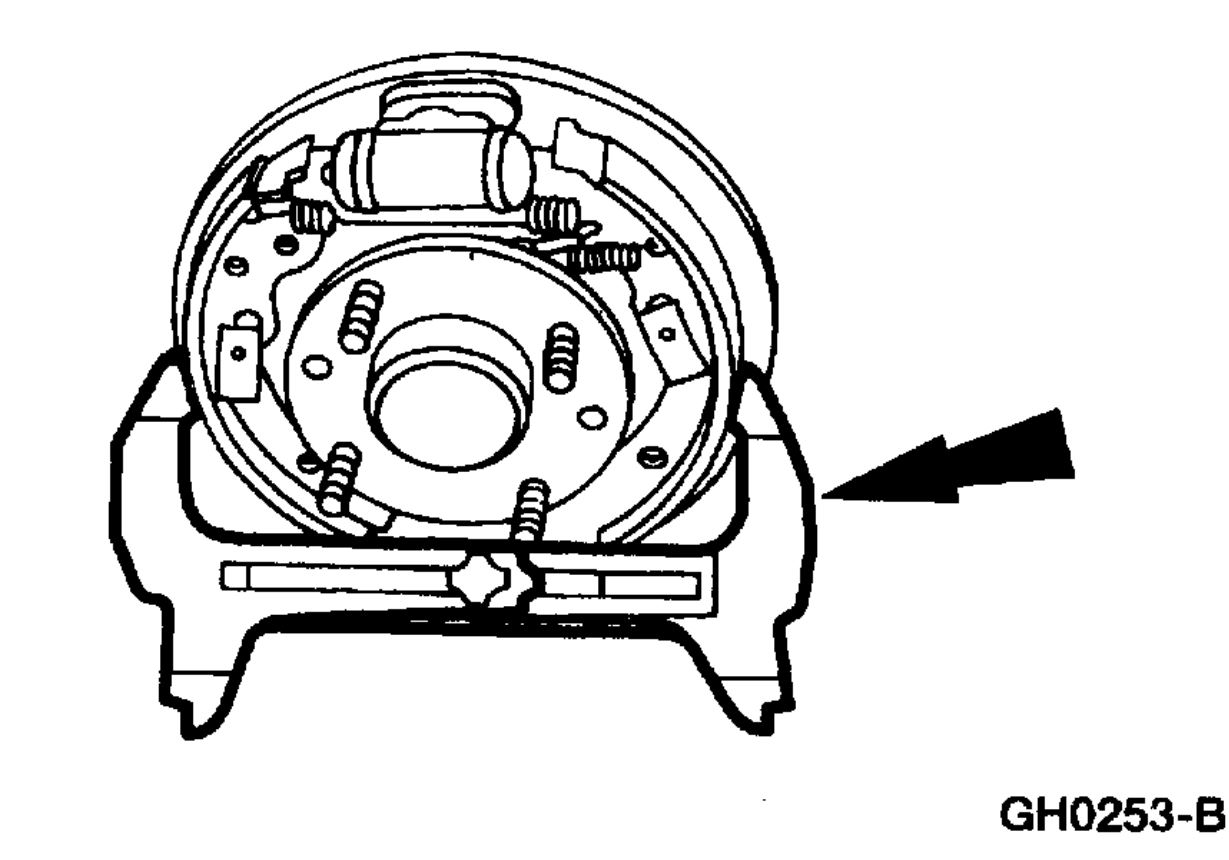

1.This adjustment should be made only after replacing brake lining or if brake applications are insufficient to actuate automatic adjuster. Raise and support vehicle. Remove wheels.

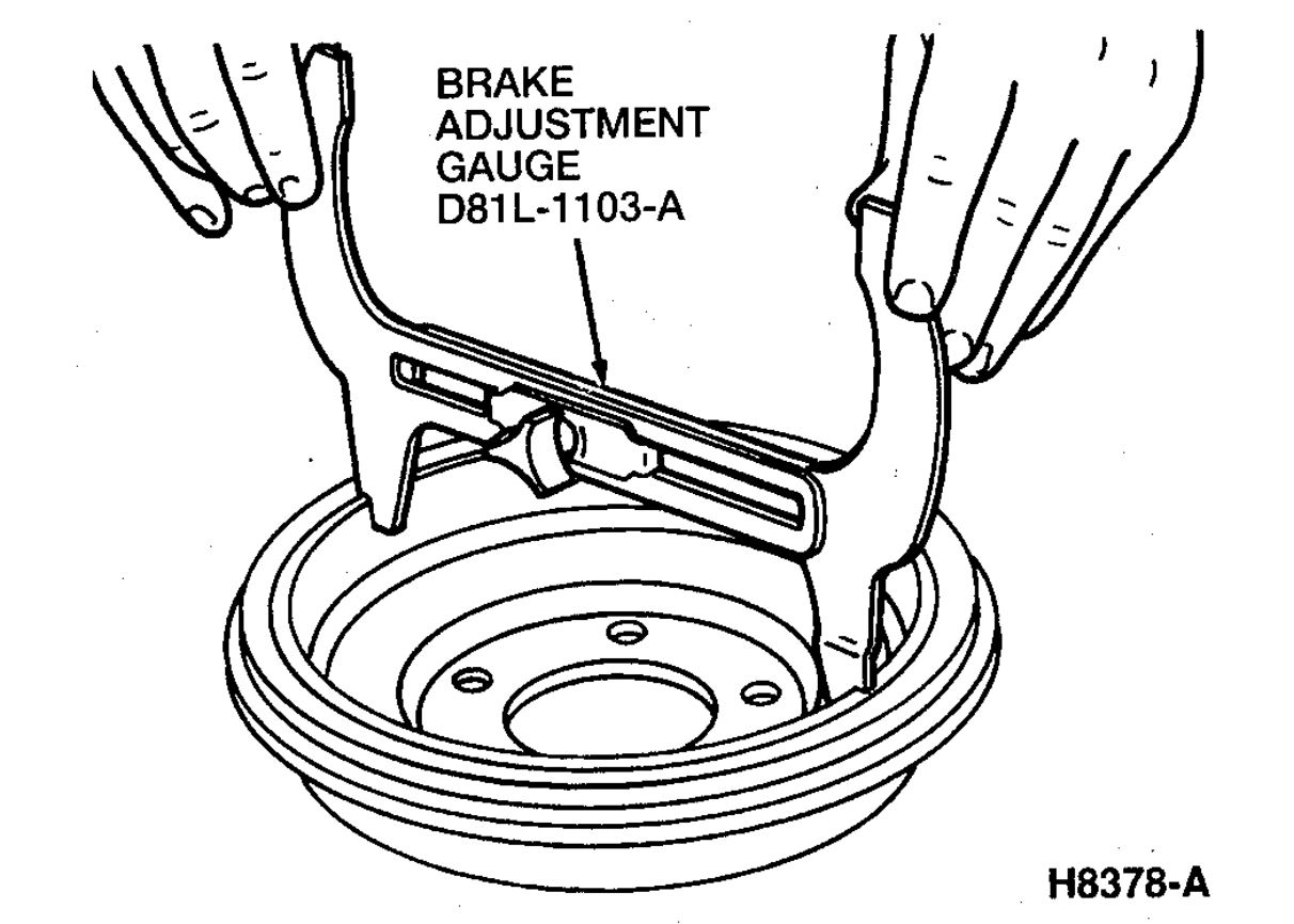

2.Remove brake drum. Using a brake drum diameter gauge, determine brake drum diameter and proper shoe diameter. Hold automatic adjusting lever out of engagement. Using a screwdriver, rotate knurled quadrant on adjuster assembly to adjust brake shoes.
3.Adjust brake shoes to fit gauge. Rotate gauge around shoe to ensure proper fit. Install brake drum. Install wheels. Check brake operation by making several stops at varying forward speeds.
