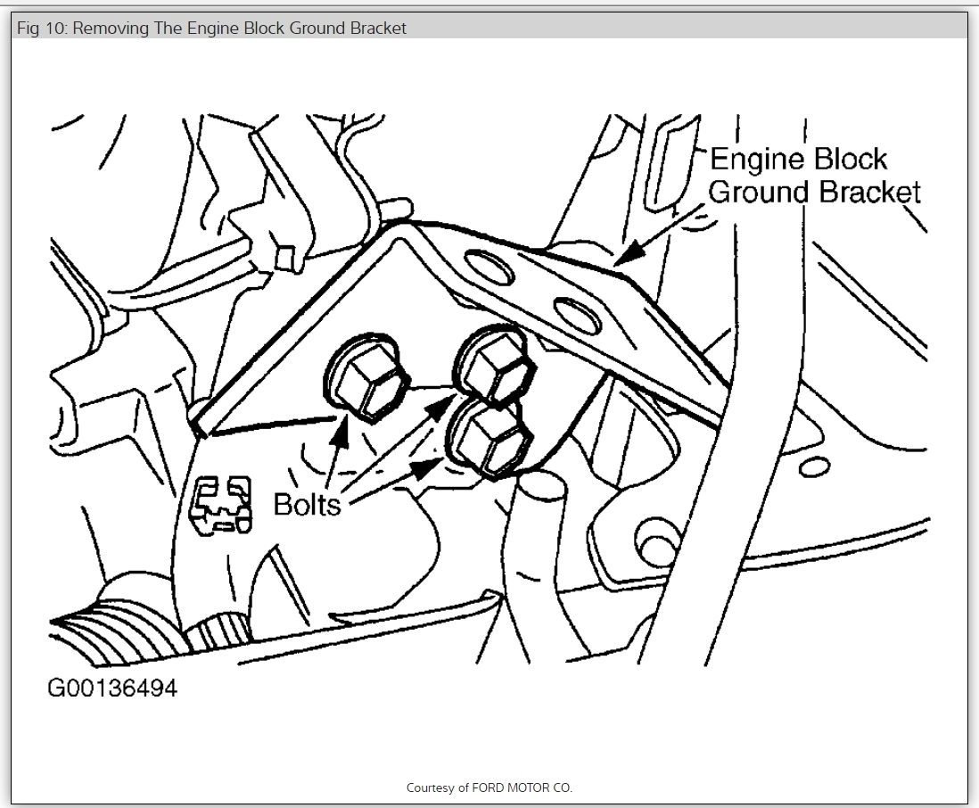

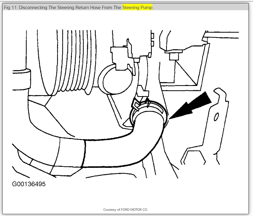

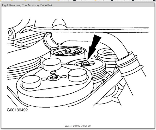

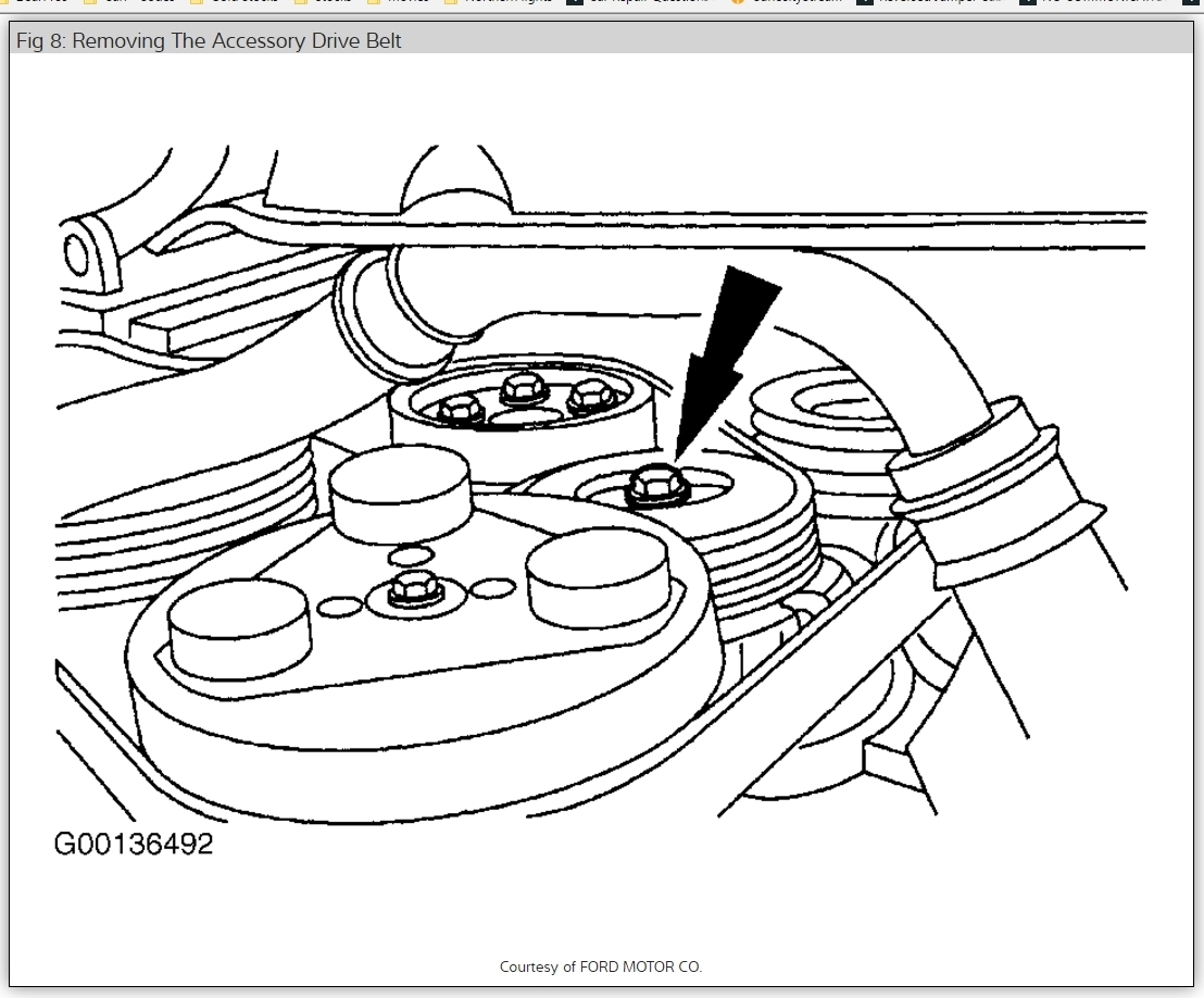

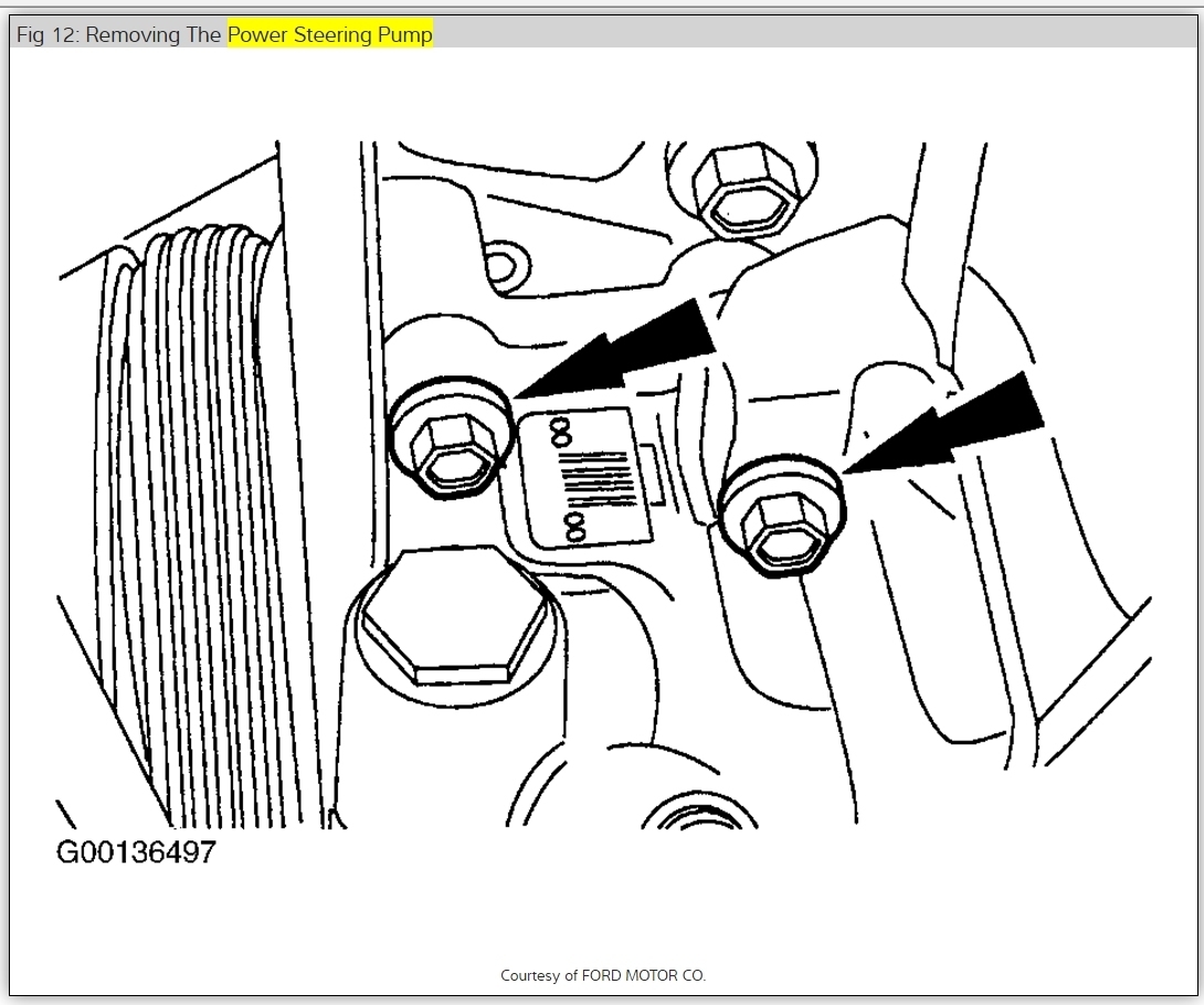

How do I remove Power Steering pump?

Here is a guide that will show you what you are in for with diagrams for your car below.
https://www.2carpros.com/articles/how-to-replace-a-power-steering-pump
and
https://youtu.be/MtHG4y_rdMI
