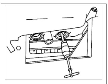

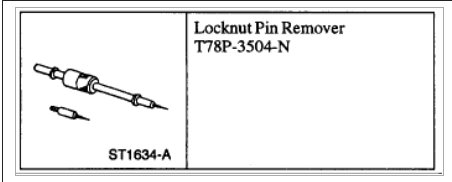

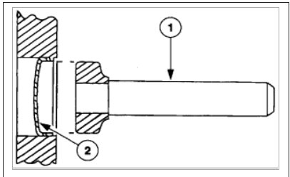

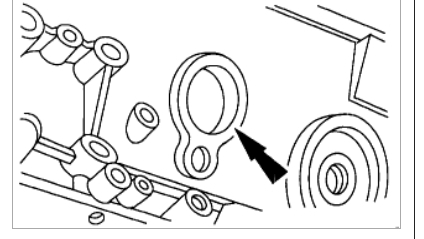

freeze plugs are on bottom side of engine and in most cars some can be removed with little problem and others need engine to be lifted to get at them you need to try and determine if your losing coolant in front /middle or rear section of motor and which side.
Here are diagrams to help you see how the job is done.
Cheers
