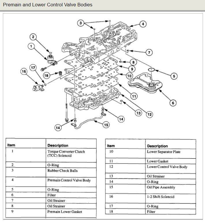

Can you provide this for me I need to know where it is?

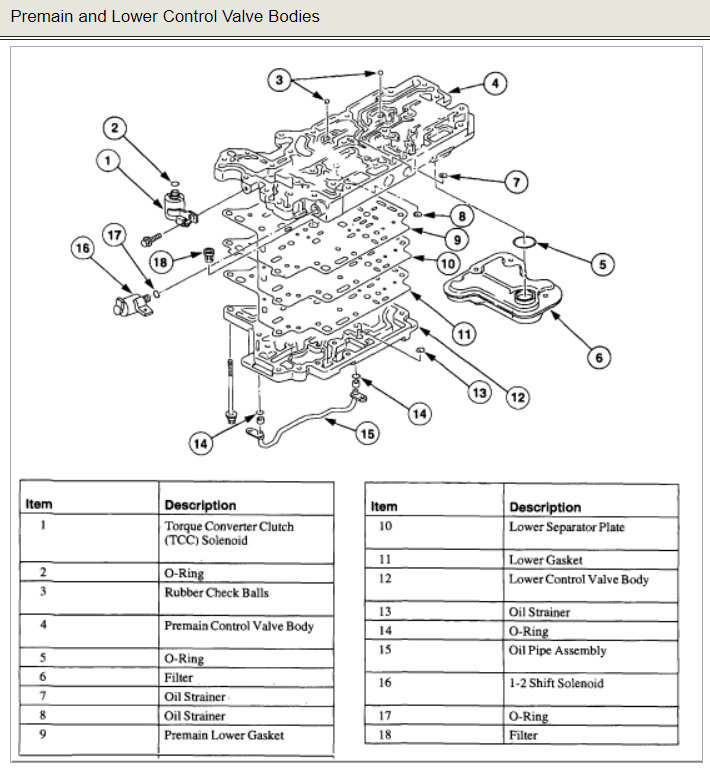

The shift solenoid is located int he transmission valve body. Here is a guide that will show you how to get the transmission pan off
Check out the diagrams (Below) that shows the solenoid locations
