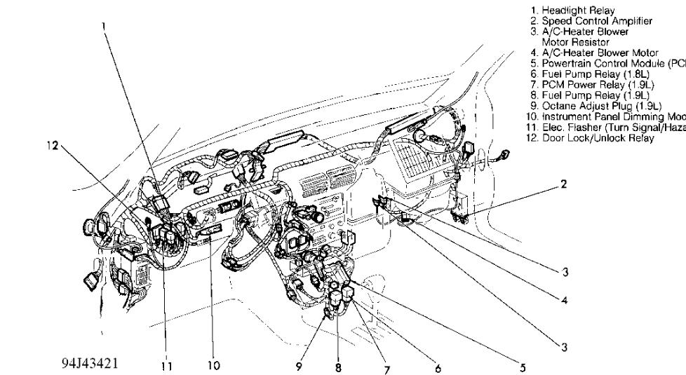

there is no sensor for fuel pump unless you mean the oil pressure switch. the relay is item 6 or 8 in pic depending on engine.1.9L is 8 the inertia switch shold have a button on top to reset
