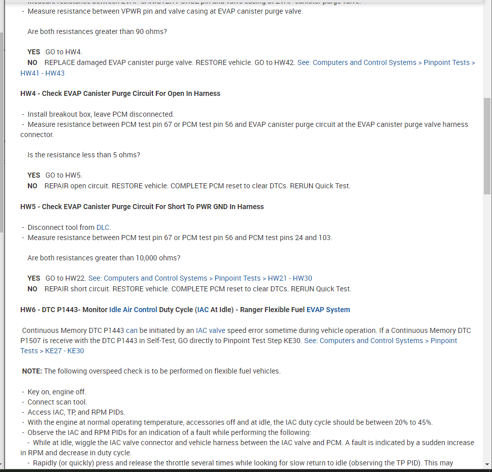

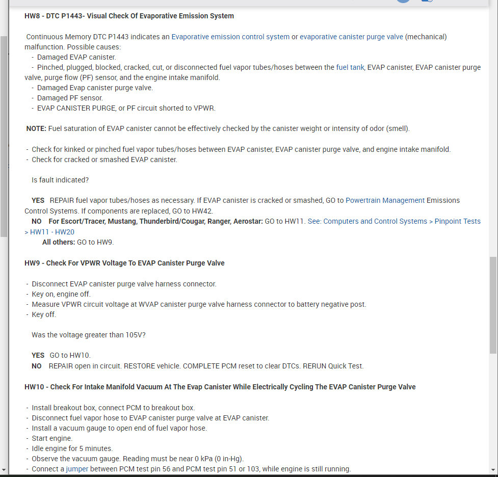

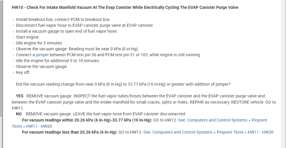

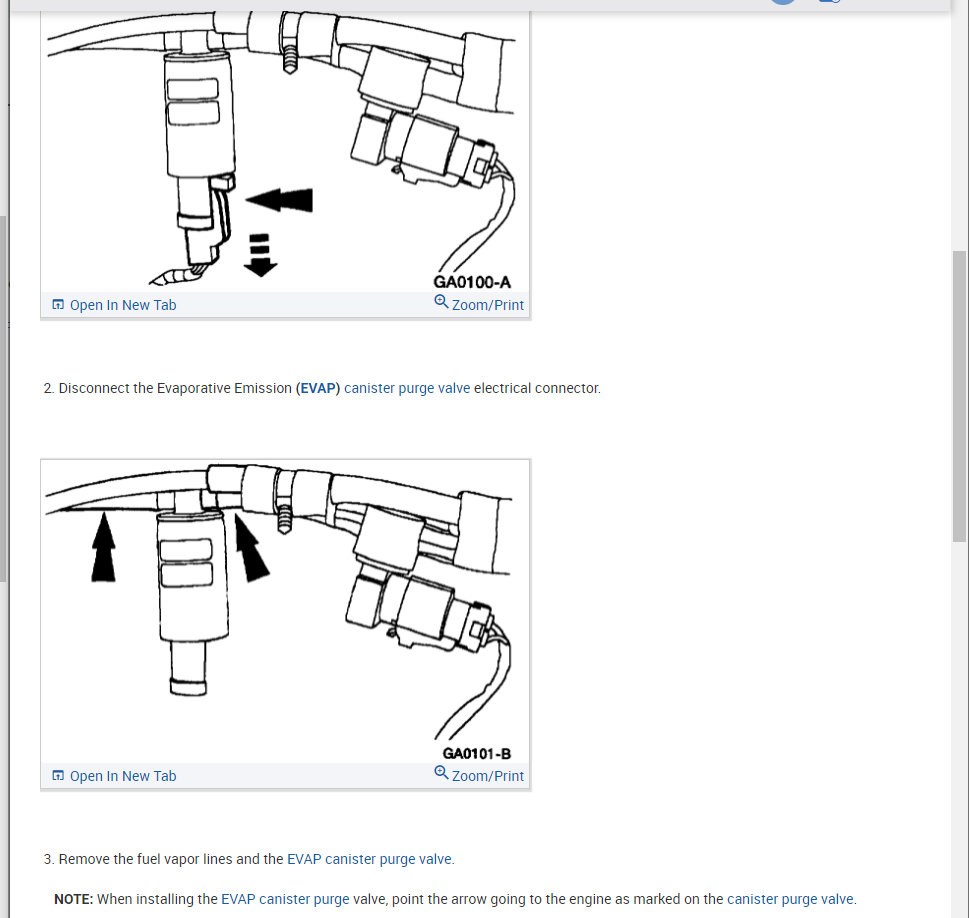

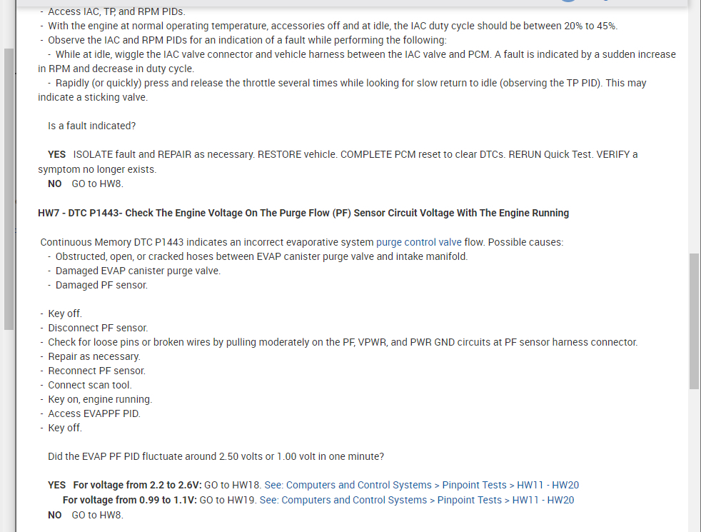

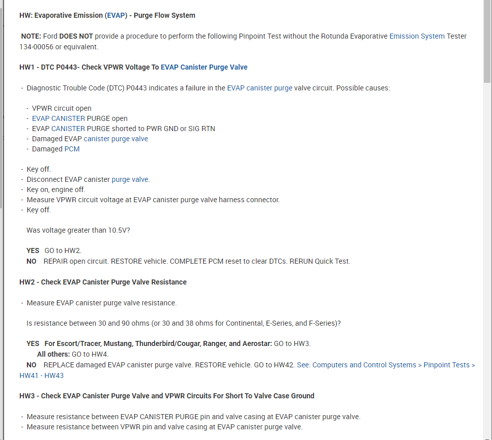

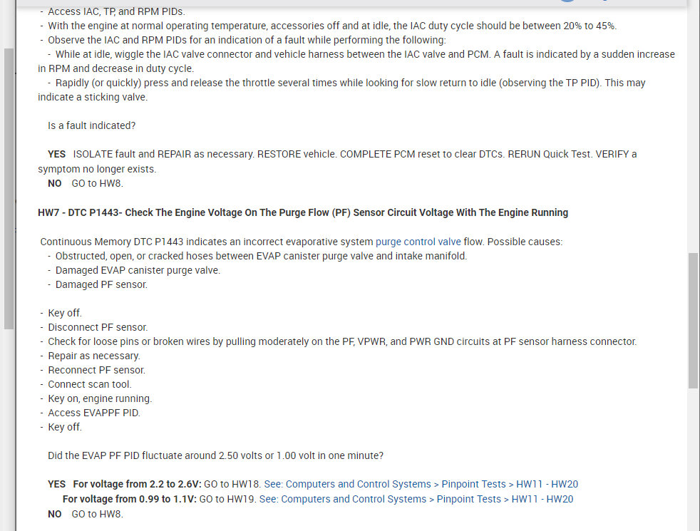

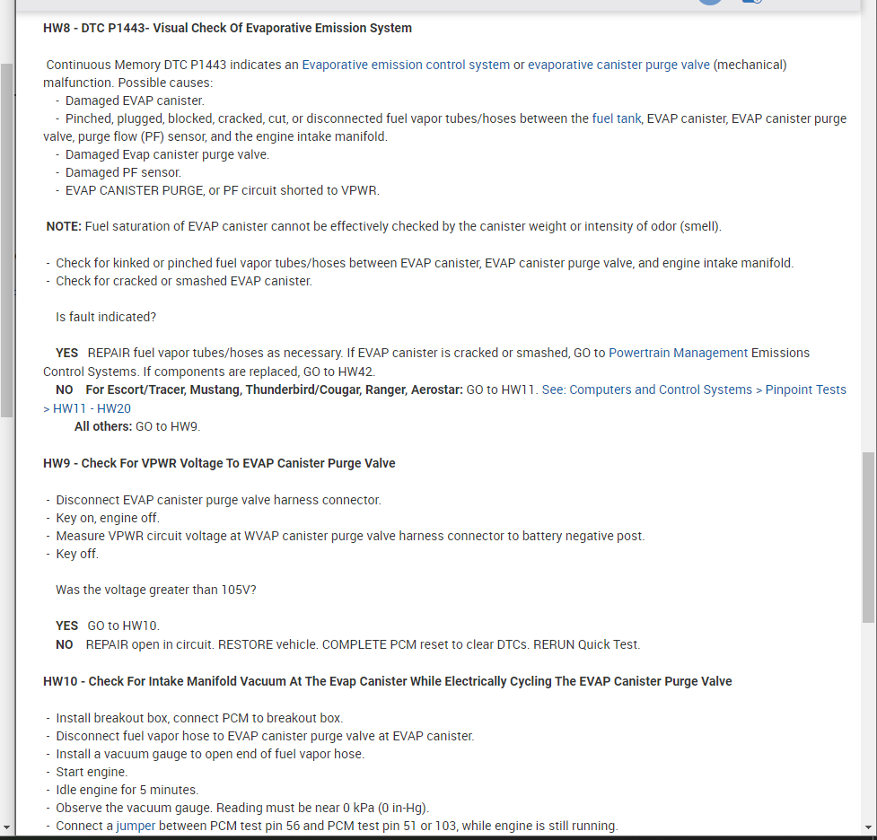

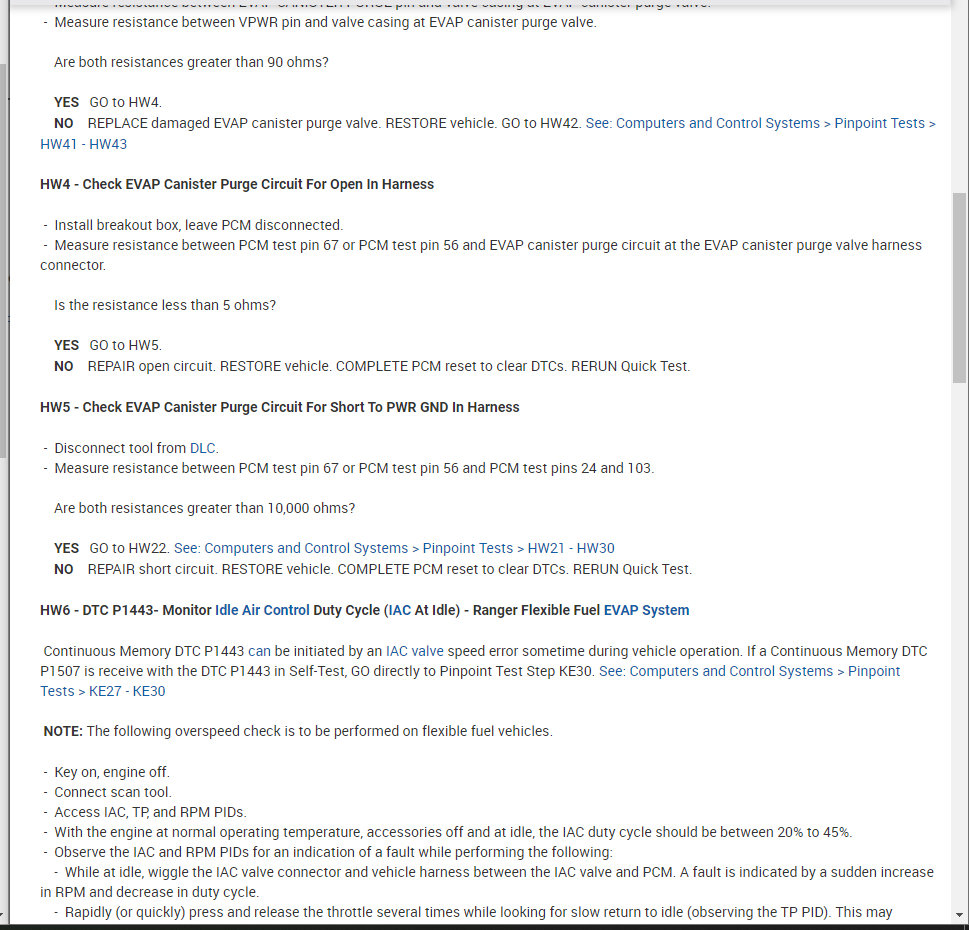

I attached the testing below for your review on this and so we need to run through this testing to find out what the issue is.

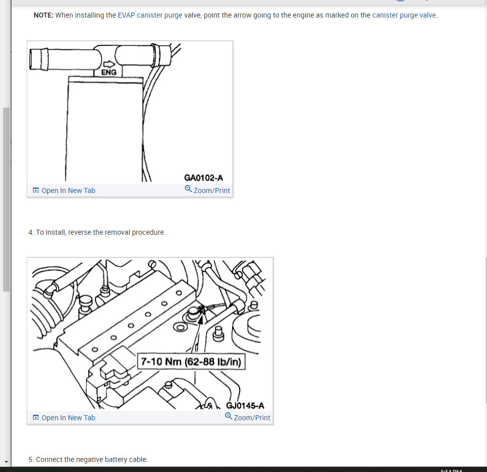

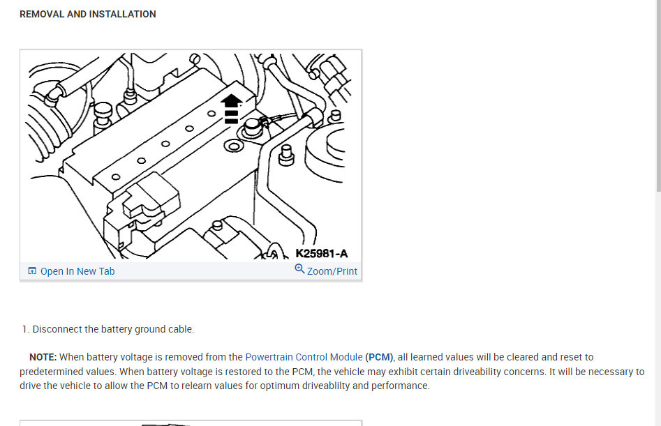

However, I suspect this is a purge valve/solenoid issue so I included the process on how to replace it.
