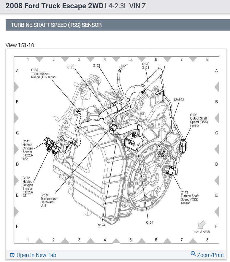

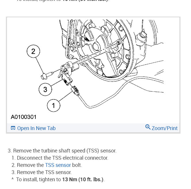

When I am driving and either slow down or speed up, sometimes my vehicle will not shift into gear and then it jerks and shifts. I have checked the transmission fluid and it is good.
Mar 5, 2010 at 12:22 PM
This sounds like a turbine shaft speed sensor has gone out but to be sure lets run the codes
Here is the location of the input shaft speed sensor. Check out the diagrams (Below). Please let us know what you find. We are interested to see what it is.
Cheers
May 5, 2010 at 10:37 AM
KENDRARUSSELL
Thanks you for this post I got a new sensor for $46.00 the car works great! I love this site.

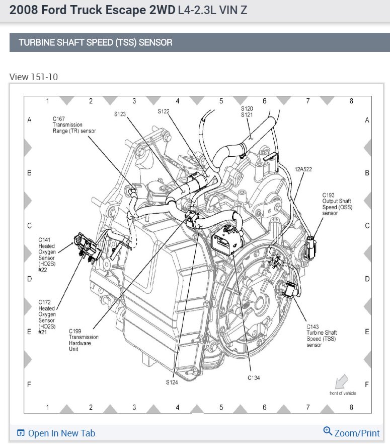

The problem Ford Escape 3.0
Battery dead then slipping on the shifting form 2-3 gear.
No DTC codes appears.
Rebuilt with:
- Master repair kit (seals frictions, gaskets, pistons etc.)
- New solenoid body
- New valve body
- New filter and almost all details in pump
- New planetary.
The result: when cold transmission (approx 10 min after start) everything OK
When hot tranny 2-3 slipping, other 1-2,3-4 soft shift
What is wrong and where to find problem?
Nov 13, 2019 at 10:48 AM (Merged)
HMAC300
  • 48,601 POSTS
It sounds like the turbine shaft speed sensor is not working correctly which may or may not create a trouble code. Here is the location so you can check it out. Check out the diagrams (Below). Please let us know what you find. We are interested to see what it is

The problem that all this done in tranny repair shop with tranny experienced guys. The scanner used for diagnosis is professional from Ford dealer in Minsk (Belarus). The plates are new, three times checked and adjusted clearance between plates. Seals and gaskets are new as well. So I did the senor and the problem is gone thanks for he help I love this site.
HMAC300
  • 48,601 POSTS
Glad you could get it fixed, that kind of problem can be tough. Please use 2CarPros anytime we are here to help.
