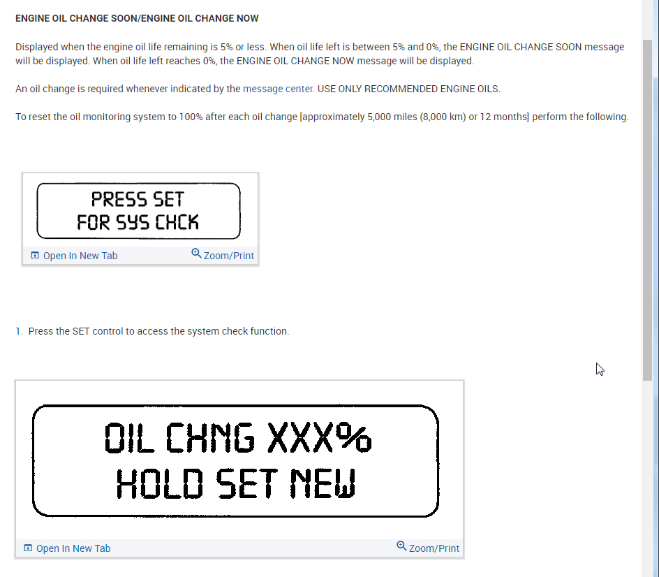

Here is a guide to help you step by step with instructions in the diagrams below to show you how on your car.
https://www.2carpros.com/articles/oil-life-reset
this is what I have
to reset- press trip/reset button on the i/p cluster, " go to setup menu hold reset" will appear. then hold trip/reset button and release. then it will display " system check hold reset"- press and hold trip reset, dont release- will display- "hold reset if new oil", then release. turn ignition off for approx. 5 sec- turn ignition back on to verify reset with no messages.
the engine oil change soon message will be displayed on message center when remaining engine oil life is 5% or less. the engine oil change now message will be displayed when engine oil life is 0%.

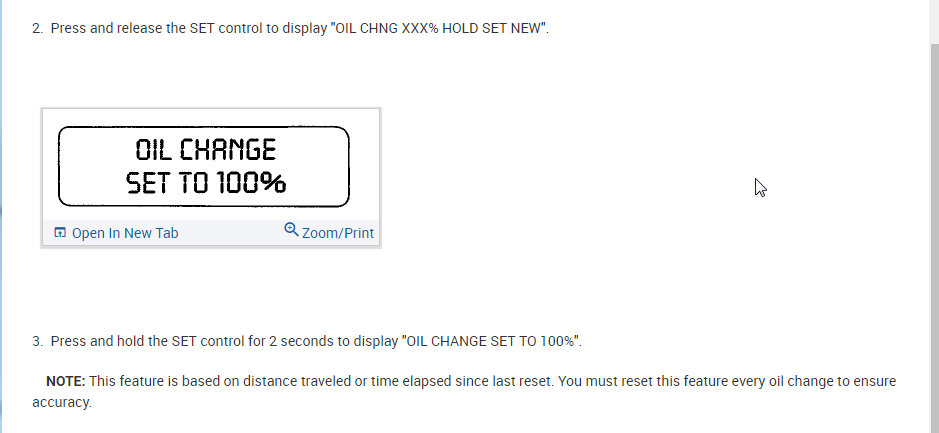

to reset the oil monitoring system to 100%, press set or select/reset control to access the system check function. press and release the set or select/reset control to display oil chng xxx% hold set new.
press and hold the set or select/reset control for 2 seconds to display oil change set to 100%. oil life is now reset.

Thanks for the update and I agree. If someone is not familiar with the high voltage system then they can get hurt pretty bad. However, resetting the oil reminder is the same as a non hybrid.
I attached the process below for your review. Also, here is a guide that will help others that don't have this specific vehicle:
