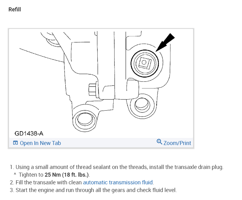

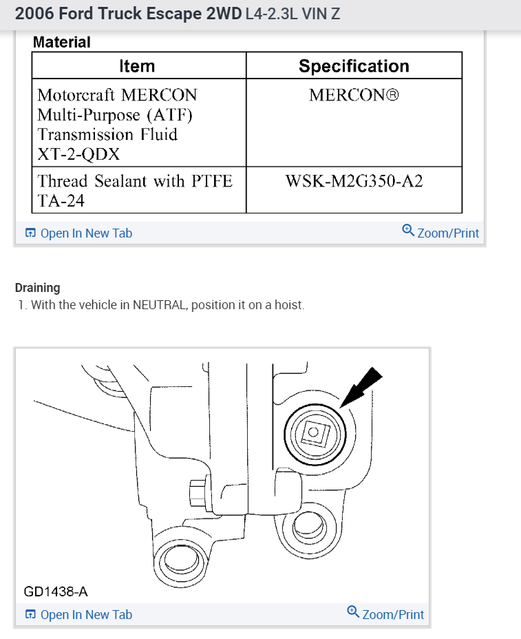

This guide will show you how with diagrams and instructions below to show you how on your car. The filter is internal just fluid is the service
Specifications
General Specifications
Item .................... Specification
Fluid
Motorcraft MERCON Multi-Purpose (ATF) Transmission Fluid XT -2- QDX .................... MERCON
Fluid Capacity
All .................... 9.6L (10.2 quarts)(3)
Lubricant
Multi-Purpose Grease XG-4 .................... ESB-M1C93-B
Sealant
Thread Sealant with PTFE TA-24 .................... WSK-M2G350-A2
(3) Indicates only approximate dry-fill capacity. Some applications may vary based on cooler size and if equipped with an in-tank cooler. The amount of transmission fluid and fluid level should be set by the indication on the dipstick's normal operating range.

are you just wanting to drain and refill the fluid? if so, place vehicle on hoist and position in Neutral. remove tranny pan bolt to empty. tighten bolt after empty and fill with 10 quarts of Mercon V tranny fluid.

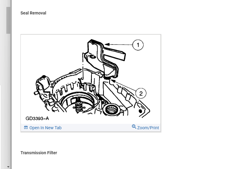

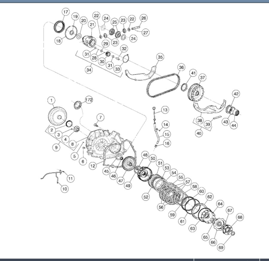

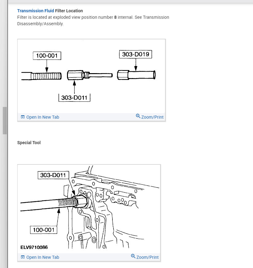

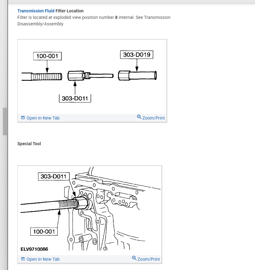

Just to weigh in on this to put this to rest for the Escape. Either of the engine options (2.3L, 3.0L) come with the CD4E transmission. This means that the filter is internal to the transmission and is not serviceable unless you are tearing down the transmission for another reason. All transmissions have a filter to prevent what was mentioned previously of friction material circulating through the unit. This would be problematic but either the transmission has a filter that is serviceable or non-serviceable but all transmissions have some sort of filter.
If you are tearing it down, then there is an issue which means the filter will need to be changed to ensure the repair is complete.
Please see the attached info on this as it is number 8 in the exploded view of the transmission.
