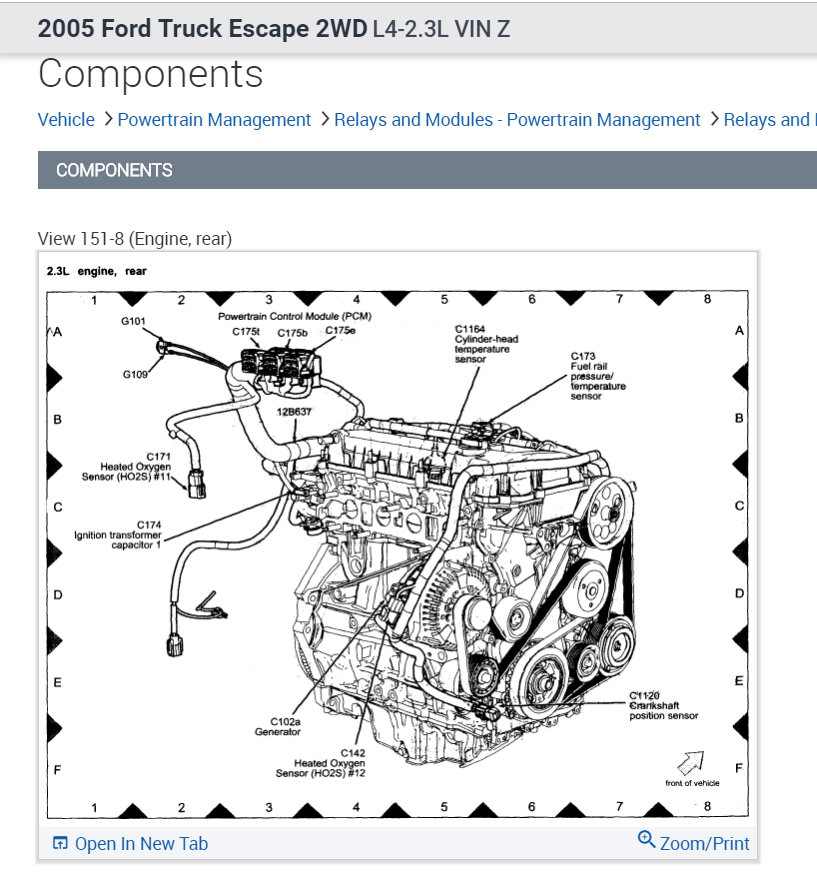

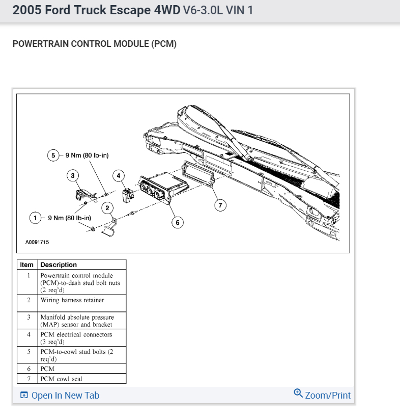

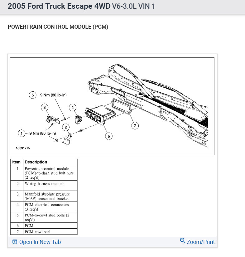

Where is the PCM located in a 2005 Ford Escape? Is there any way I can troubleshoot it/ replace it myself?
Sep 9, 2009 at 11:00 AM
JDL
CERTIFIED EXPERT
16,098 POSTS
The engine PCM is located on the firewall on the passenger's side here are diagrams below to show you the location.
