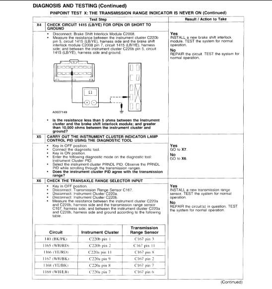

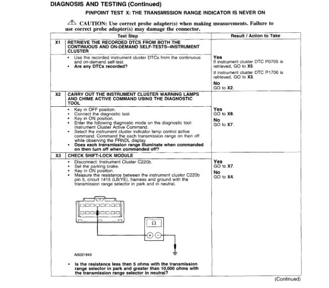

hello, vehicle is four wheel drive. when i drive car at highway or city at 50-70 mph and i release foot from gas pedal it shifts at third gear and when i press gas pedal again it shifts fourth gear. no check engine light. i plugged scanner and found DTC p0705 Transmission Range Sensor Circuit Malfunction.
Can it be the reason of the problem?
