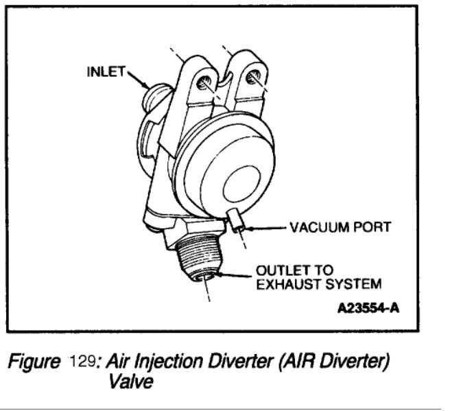

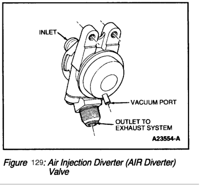

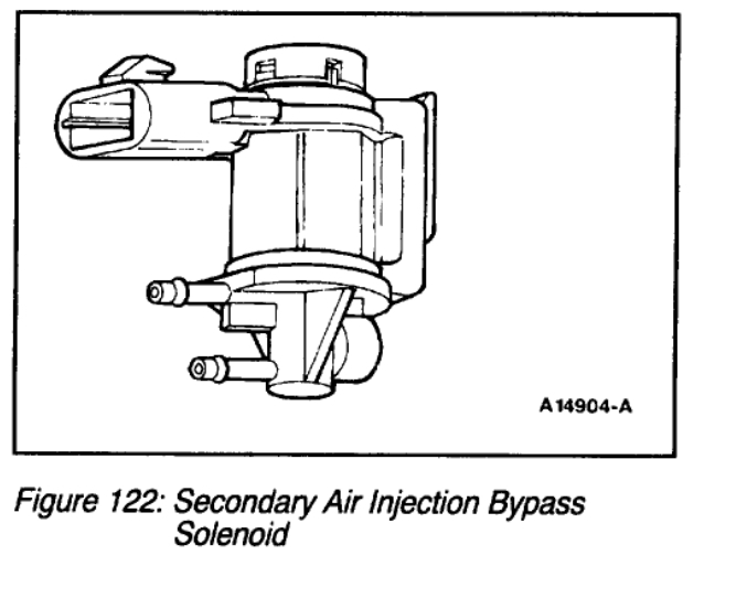

Check to make sure the air diverter valve is not stuck open because it sounds like it is allowing extra air into the exhaust system causing the catalytic converter to glow red hot. Check to make sure the control valve is not stuck open as well.
Here are some guides to help you see what I am talking about
Please let us know what you find.
Cheers

Even though the car seems like it is idling fine I checked the air diverter valve and sure enough the valve has stuck open so I replaced it and the problem is fixed.
Thanks 2carpros! you guys are great!
