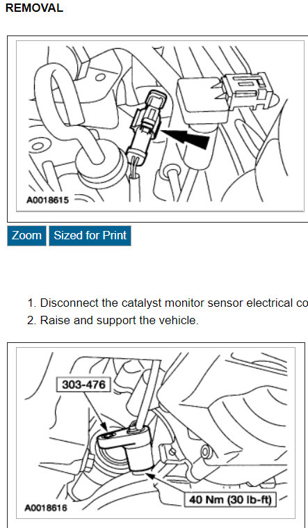

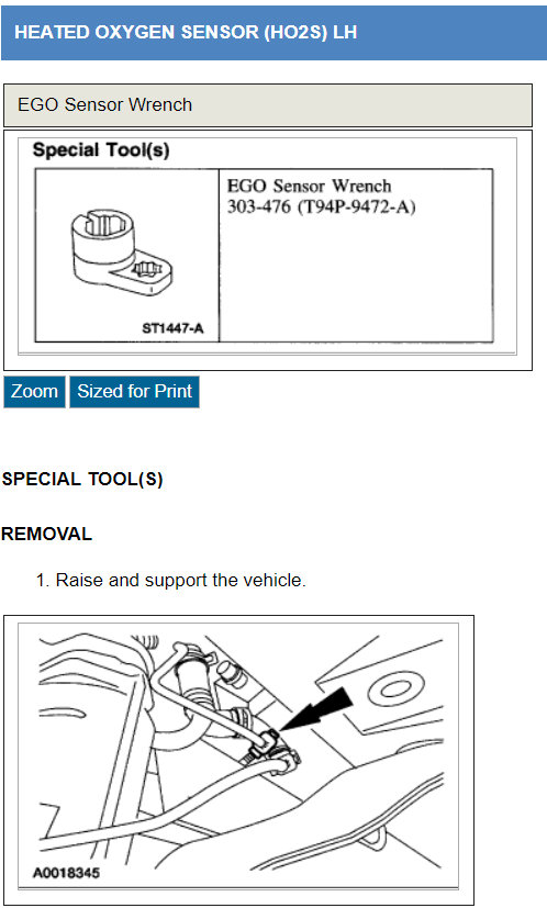

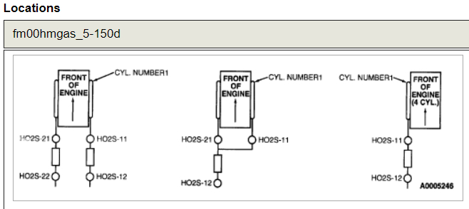

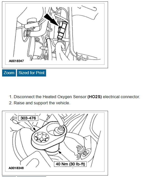

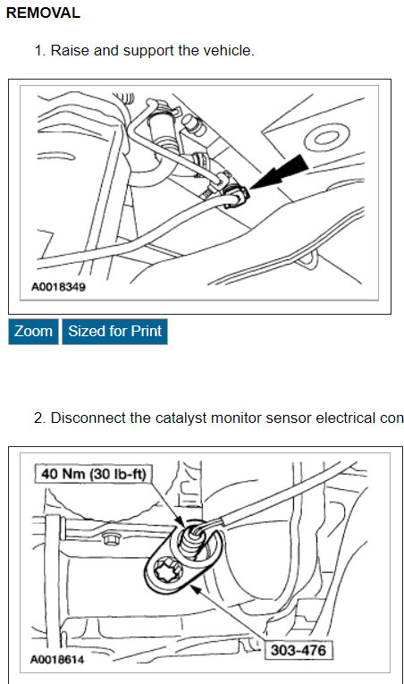

Here is a guide that will help you replace the oxygen sensor in your car. The number one cylinder which is bank one is the left side of the engine if you are looking straight onto it. (right side of engine)
https://www.2carpros.com/articles/how-to-replace-an-oxygen-sensor
You may need to jack the car up.
Here are the locations to all of the o2 sensors
Cheers

The upstream sensors are located in the exhaust before the catalytic converters... the downstream are after the cats

Bank two is on the passenger side. Most systems have an upstream, (closest to the engine), and a downstream, (behind the catalytic converter) oxygen sensor on each bank. The downstream one is just for monitoring the efficiency of the converter.
