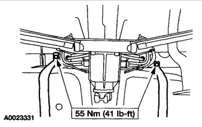

It does sounds like the fuel pump when out can you hear it running in the tank with the key on?

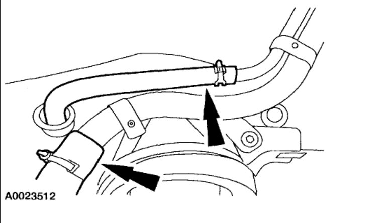

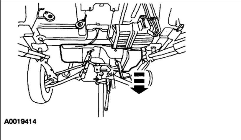

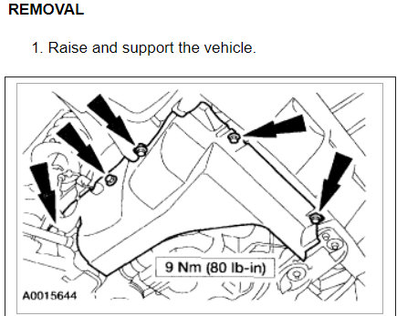

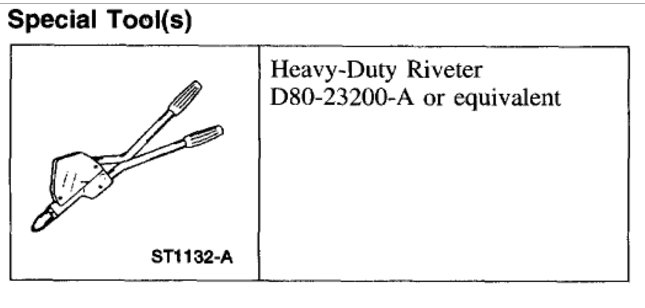

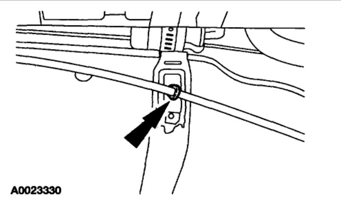

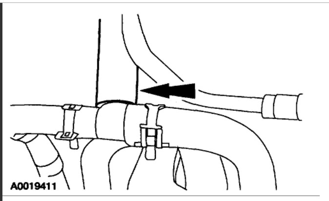

Here is a guide to help you see what you are in for when changing the pump out.
Here is how it will be for your car (below) you can find the pump on Amazon for about $140.00 so the rest will be labor.

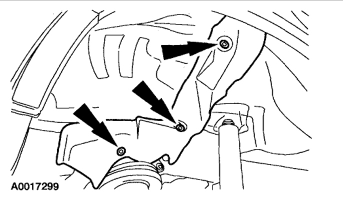

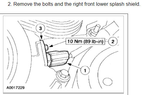

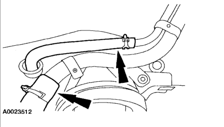

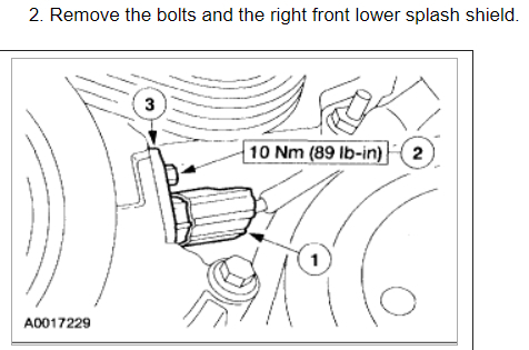

This sounds like a crankshaft angle sensor is failing which can happen without triggering a check engine light. Here is a guide to show you what you are in for when doing the job:
This is what it will be like for your car (below).
Here is a guide that covers all of the bases:
Check out the diagrams (below).

Yes is sounds like the crank angle sensor has failed, when this sensor fails it sometimes wont throw a code, here is how you check it https://www.youtube.com/watch?v=RvuzZJqQDf4
