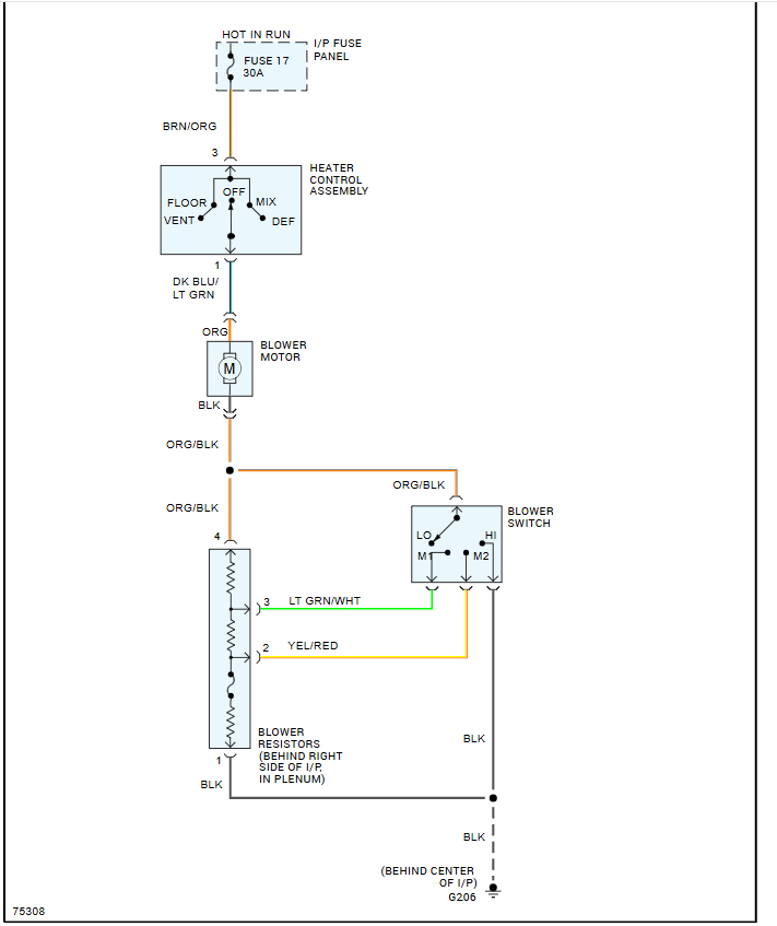

Yep, it sounds like the blower motor is going bad which is common. Test for power at the blower motor when it is not working on both wires, if you have power to one wire, the blower motor is bad and you need a new one. This video guide will help
https://www.youtube.com/watch?v=Hlna_kUt7As

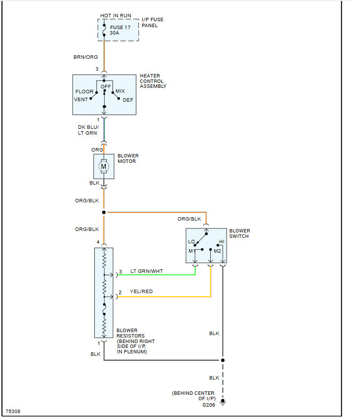

I think this is the wiring diagram for it. Check out the images (below). Please let us know what happens. Ken

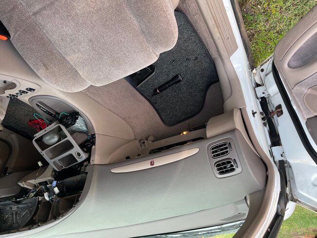

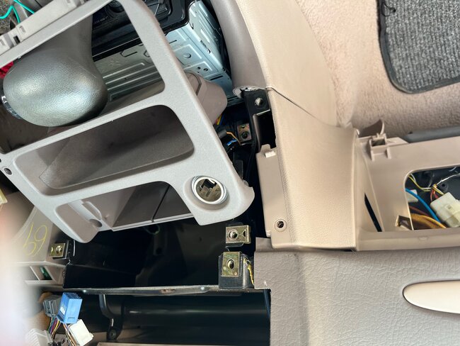

I have 2 EL faimonts - a 97 station wagon and a 96 sedan, the latter still below 92000k
Both are RH drive models. The station wagon also has a dead climate control. The attached pics show the CCU removed again from the sedan because I previously checked for dry joints and I want to make sure I have not inadvertently shorted something out. The previous test drive was at night and everything came alive after a while. The most recent test drive was also at night and the CCU did not come alive after about 15k as before

pic #2
Mar 8, 2026 at 8:57 AM

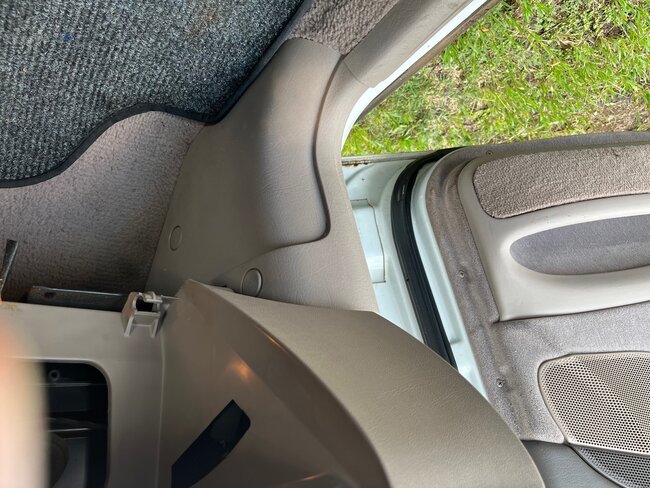

TONYAIMER
  • 10 POSTS
pic#4

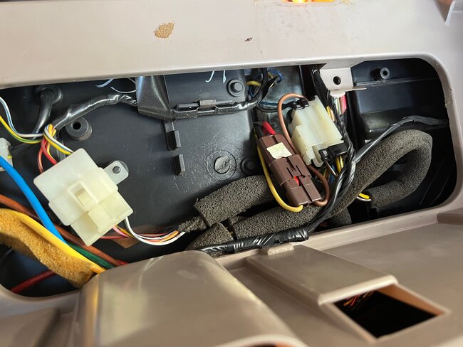

TONYAIMER
  • 10 POSTS
pic #5

The blower motor it up under the dash on the passenger side, not in the middle. Also, pop the hood and look towards the firewall, ( passenger side) thank for the images it helps.
