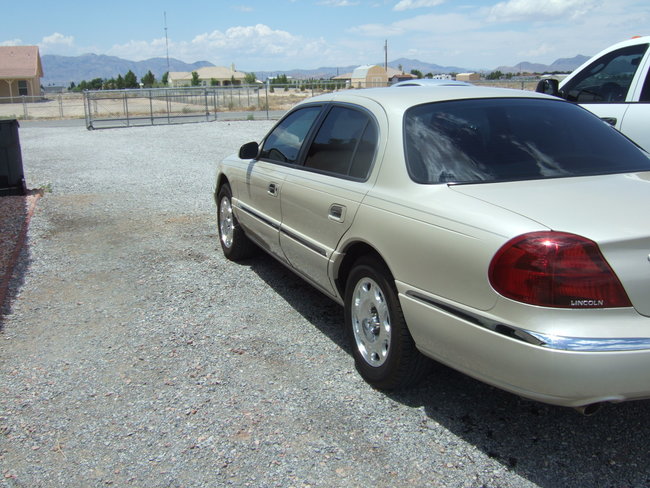

Maybe so, but the steering wheel is at about ten degrees to the right when driving straight. I have work to do on it. Beautiful with only 91,000 miles.
