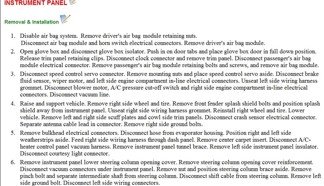

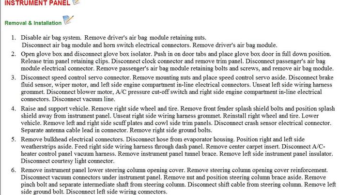

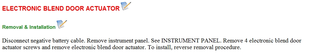

trying to removemy blend door motor on a 99 ford crown victoria where do i start?
Aug 6, 2019 at 10:24 AM (Merged)
BLUELIGHTNIN6
  • 16,542 POSTS
see steps attached
