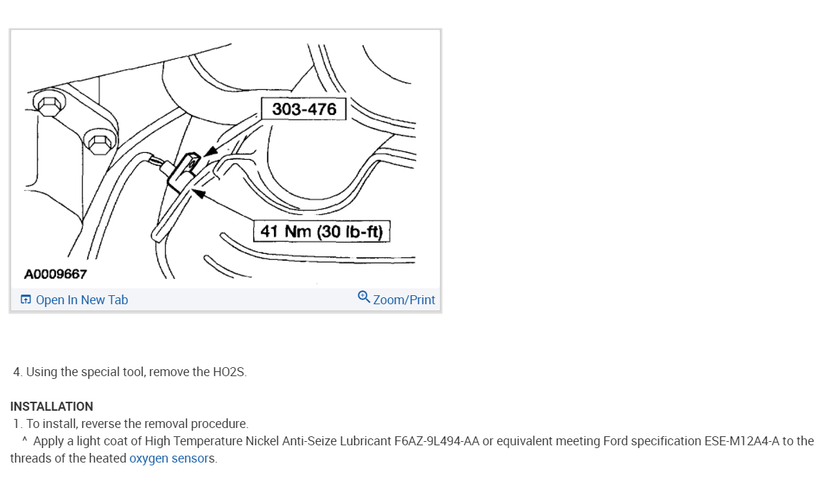

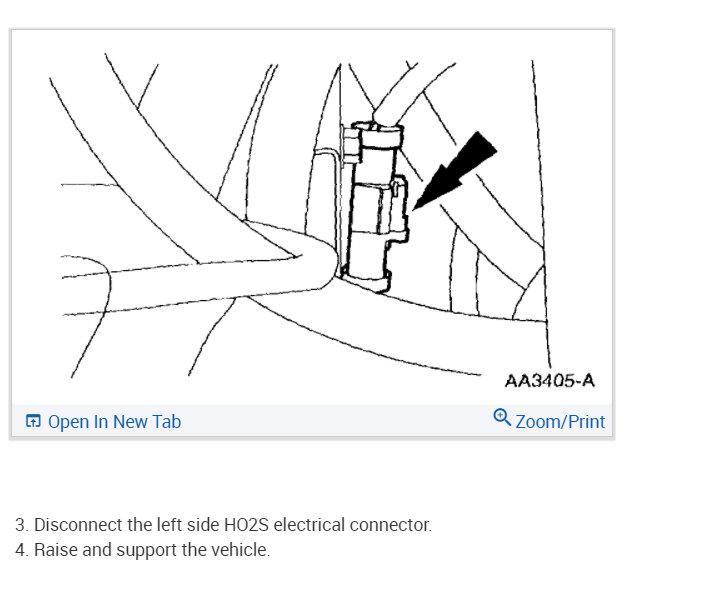

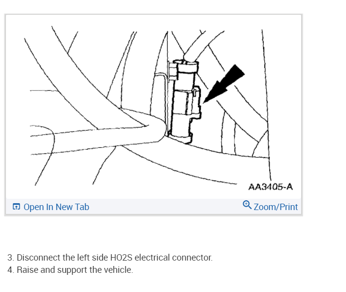

BUT FIRST BEFORE ANY OF THIS... try to see if you have uneven exhaust pressure coming out the tailpipe. If one side of the exhaust is pouring out more exhaust than obviously something is wrong. If they're even then it's probably something else. You could buy 2 new O2 sensors and put them in there (lots of $$ and the old ones might be tough to get out)...but scan the computer codes first (go to Autozone, they'll do it) and see if it comes back malfunction in one (or both) of the sensors.
