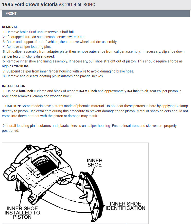

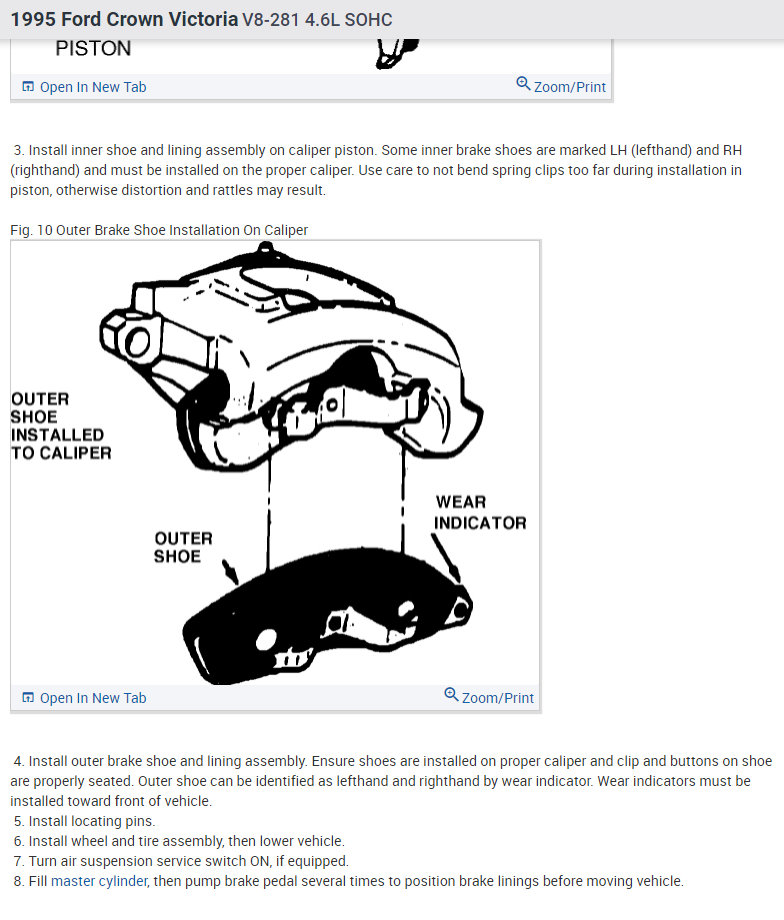

I just put new brakes on my Crown Vic (in the process I had to replace the parking brakes shoes, which was NOT fun) but I can't remember where the anitrattle spring went. In other words, I don't know if it went above or below the mount that the pad sits on. The pads are not sitting where they should be and I don't know if the antirattle spring is misplaced or if I missed a step. I have done brakes plenty of times and this is the hardest time I have ever had. But, I do love Ford, so I can deal with it!
