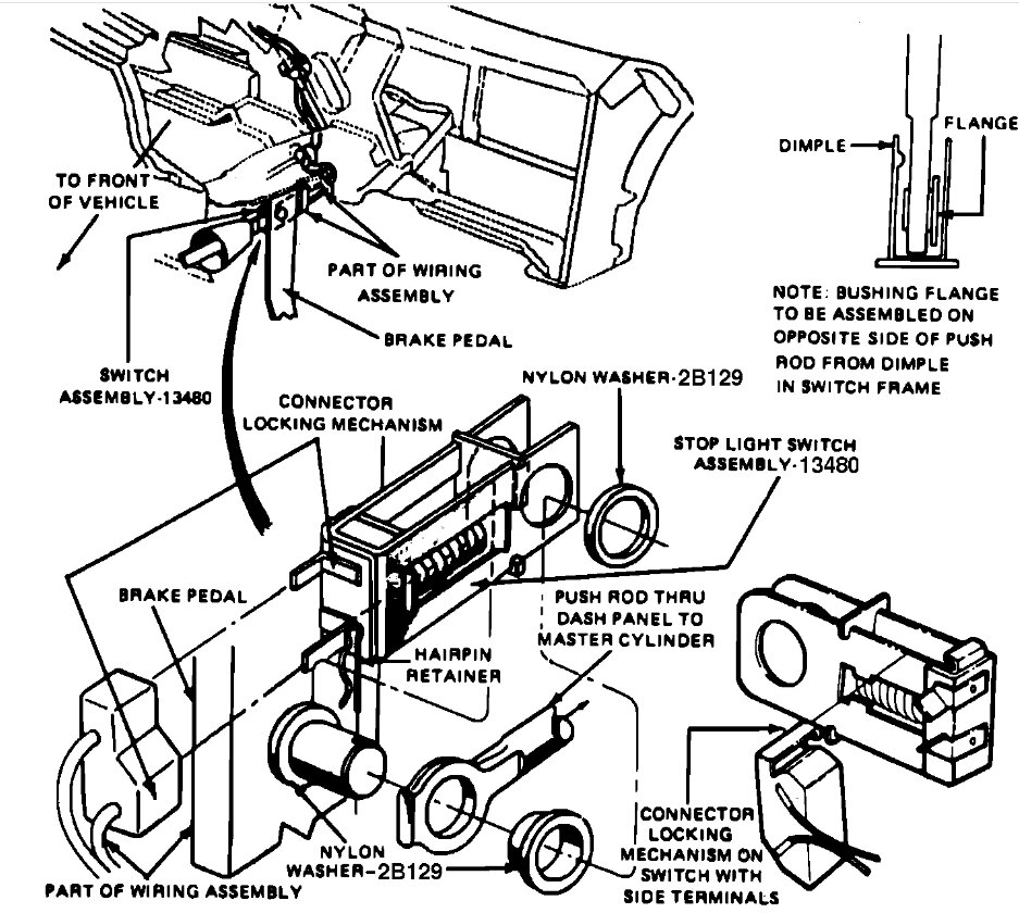

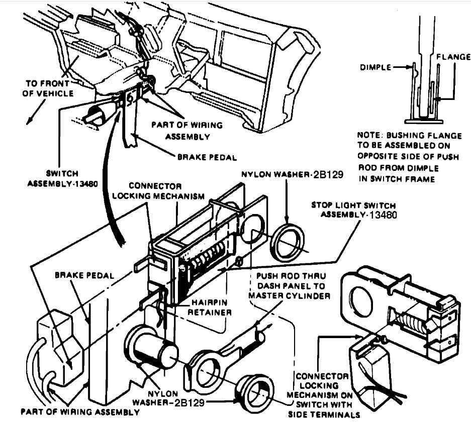

How does the brake light switch work?
How do you install a new one?
The problem is that I have to press quite firmly on the brake pedal for the brake lights to come on.
