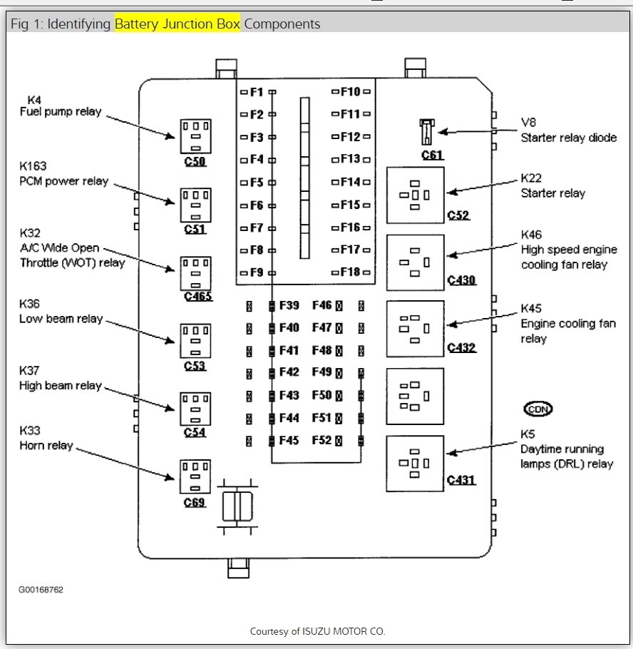

I AM TRYING TO FIND THE DIAGRAM FOR MY FUSE FOR THE BLINKER
Apr 28, 2010 at 1:03 AM
Hey Michelle,
Here is the fuse panel detain for you, Please let us know if you need anything else.
Fuse Number Amperage Circuit
F1 ..... Not Used
F2 7.5 Generator
F3 20 Fog Lamp Relay
F4 ..... Not Used
F5 ..... Not Used
F6 3 Powertrain Control Module, (Bi-Fuel Control Module, 2000 Only)
F7 20 Horn Relay/Multifunction Switch
F8 ..... Not Used
F9 15 Fuel Pump Relay
F10 ..... Not Used
F11 20 PCM Power Relay/Ignition Transformer
F12 ..... Not Used
F13 20 Heated Oxygen Sensors
F14 7.5 ABS Control Module
F15 7.5 Headlamp (Right)
F16 7.5 Headlamp (Left)
F17 7.5 Headlamp (Right), Instrument Cluster
F18 7.5 Headlamp (Left)
F39 ..... Not Used
F40 (1999) 20 Ignition Switch/Light Switch, Central Junction Box Fuse F26
F40 (2000) 20 Light Switch
F41 (1999) 20 PCM Power Relay
F41 (2000) 20 Ignition Switch, Fuse F26
F42 40 Central Junction Box Fuse F37
F43 ..... Not Used
F44 ..... Not Used
F45 60 Ignition Relay
F46, F47, F48 ..... Not Used
F49 60 Engine Cooling Fan Relays
F50 ..... Not Used
F51 60 ABS Control Module
F52 60 Rear Window Defogger Relay, Courtesy Lamp Relay, Central Timer Module, Central Junction Box Fuses
Please run some tests and get back to us so we can continue helping you.
