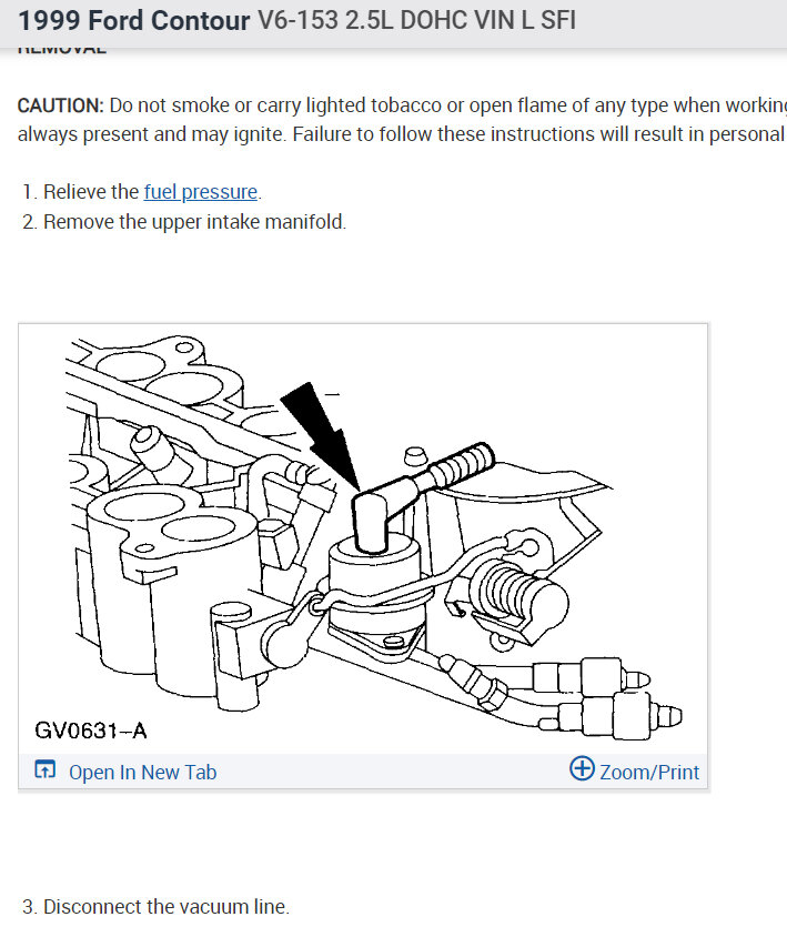

HI there,
The fuel pressure regulator in on the fuel rail. Check out the images (below). Let us know if you need anything else.

Hi there, You have me stumped, the pressure regulator should be on the back of the fuel rail,
https://www.2carpros.com/forum/automotive_pictures/61395_Capture_66.jpg
This is from Mitchell 1 data base, now it isn't a dedicated LPG fuel car is it? silly question but it is still a petrol engine? if it is not there i just do not know why, there is no other place for it to be, is there any spot on the fuel rail to accept it? has it been removed and the port blanked off? that is about all i can think off. mark (mhpautos)
