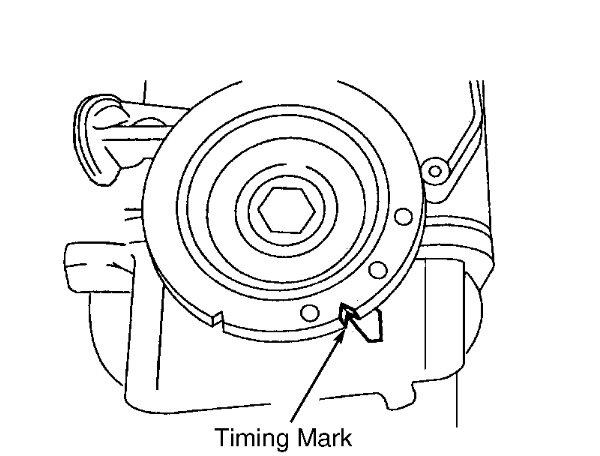

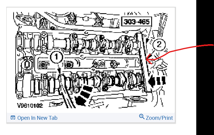

So there is a tool or bar that plugs into the rear of the camshafts and then you set the crankshaft at TDC, please check the images below to see what I mean.

9.Remove the spark plugs. Turn the engine to TDC on cylinder No. 1. To remove the tension on timing belt, unscrew the timing belt tensioner bolt (1) 4 turns. Position the tensioner so the locating tab (2) is at approximately the 4 o'clock position. Line up the hex key slot (3) in the tensioner adjusting washer with the pointer that is located behind the pulley.

10.Remove blanking plug (1) from center of exhaust camshaft pulley. Loosen, but do not remove, exhaust camshaft sprocket bolt (2). Loosen, but do not remove, intake camshaft sprocket bolt (3). Remove timing belt.
