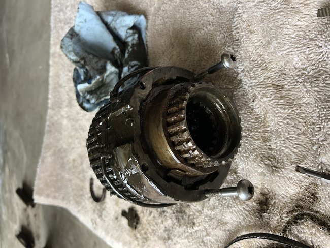

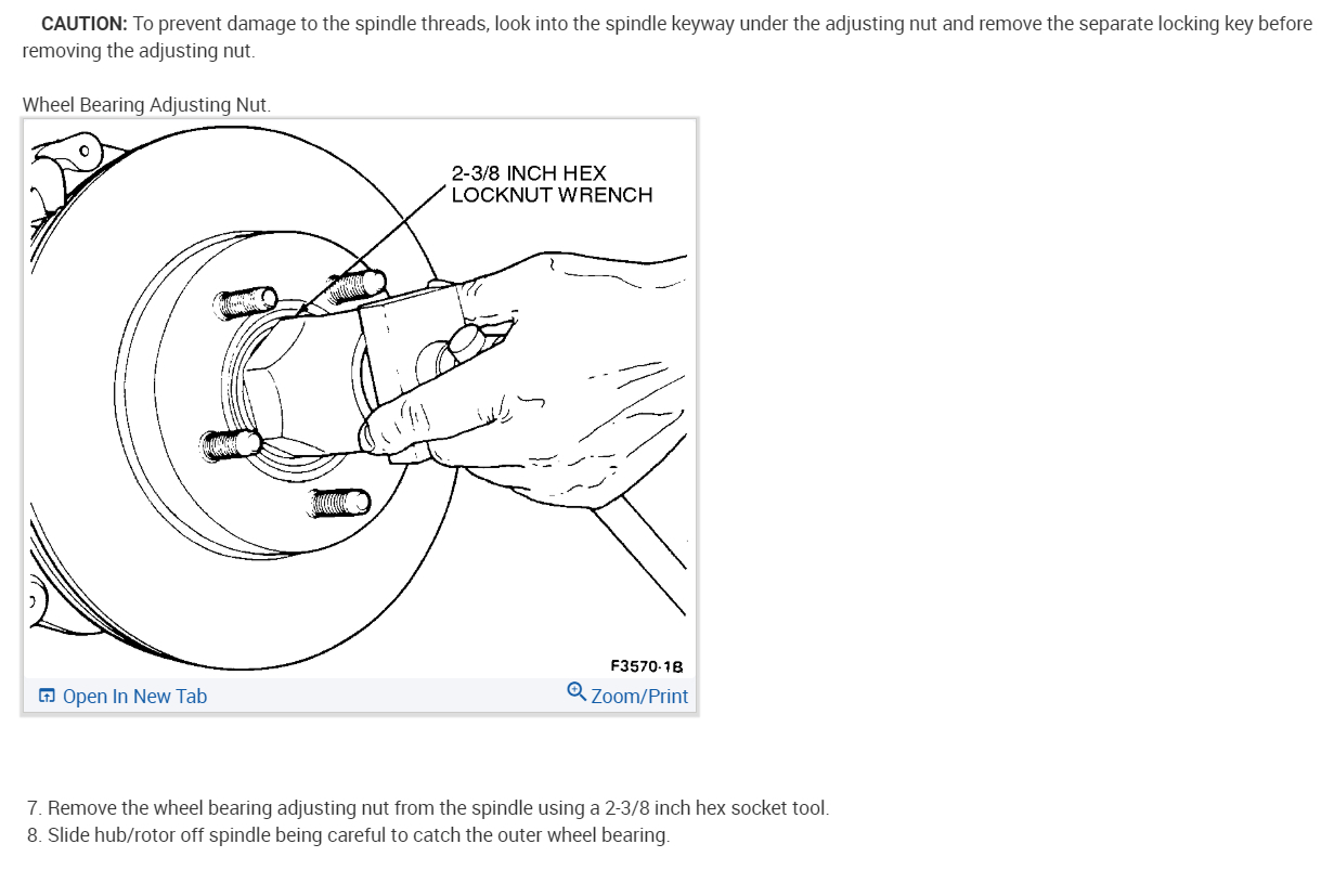

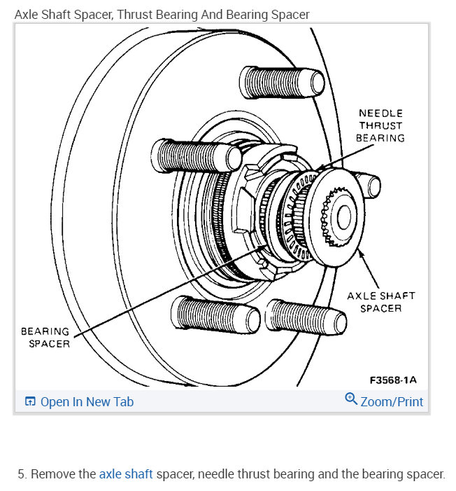

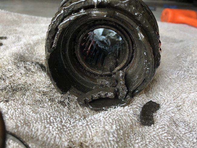

DONNY GURRUSQUIETA

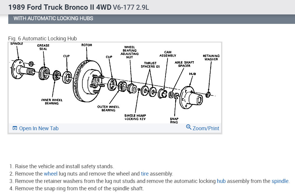

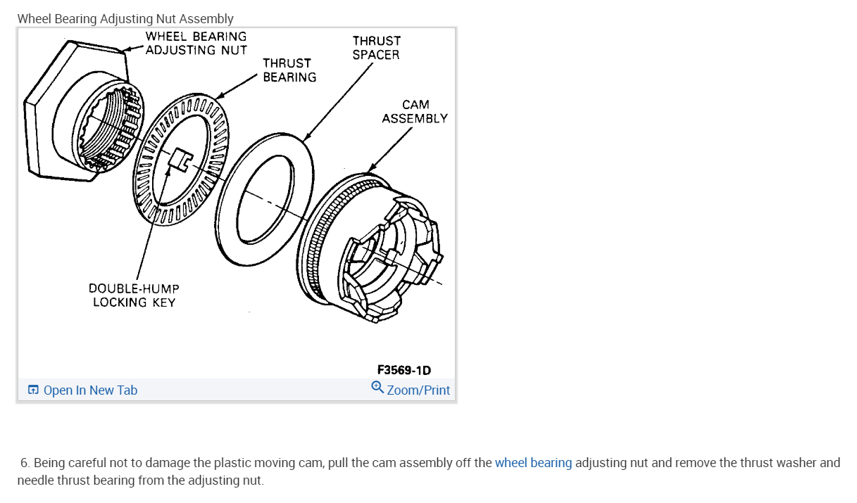

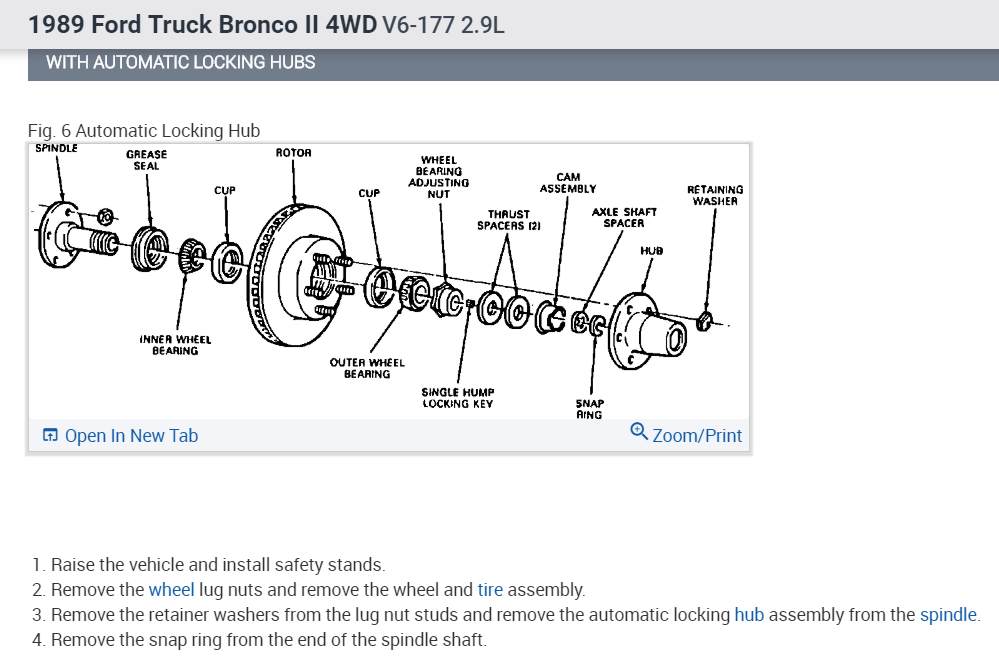

I have a similar problem with the assembly but mine is auto. I was able to pull the hub assembly but as I pulled the it off, pieces of what appear to be a gear ring fell off. Have no clue what or where they need to be replaced. I stopped there and haven’t pulled off the spindle nut to get to the bearings. Does anyone have an exploding diagram that I can reference to see what this part is and order a replacement somewhere? Also maybe a procedure or link on how to replace the rotors since these are shot(original) :-0? Thanks!!
Sep 5, 2019 at 10:41 AM (Merged)
Here are the diagrams for the front auto locking hubs. Check out the diagrams (below). Please let us know if you need anything else to get the problem fixed.
