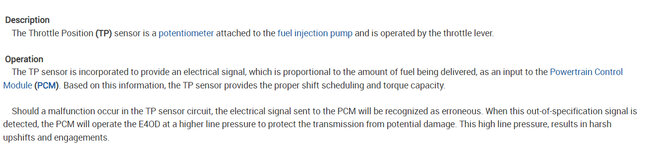

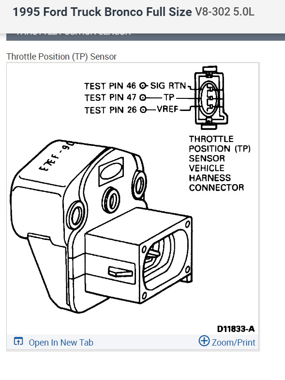

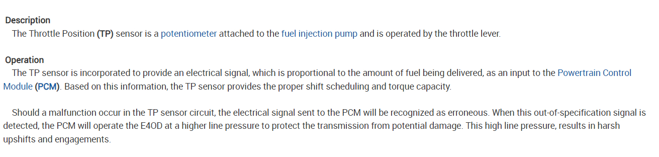

I have seen a bad TPS sensor cause this problem, here is how to swap it out to help fix the issue. Check out the images (below). Please let us know what happens.
