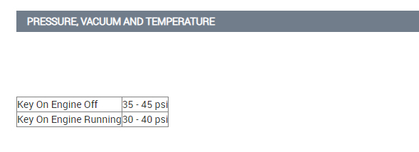

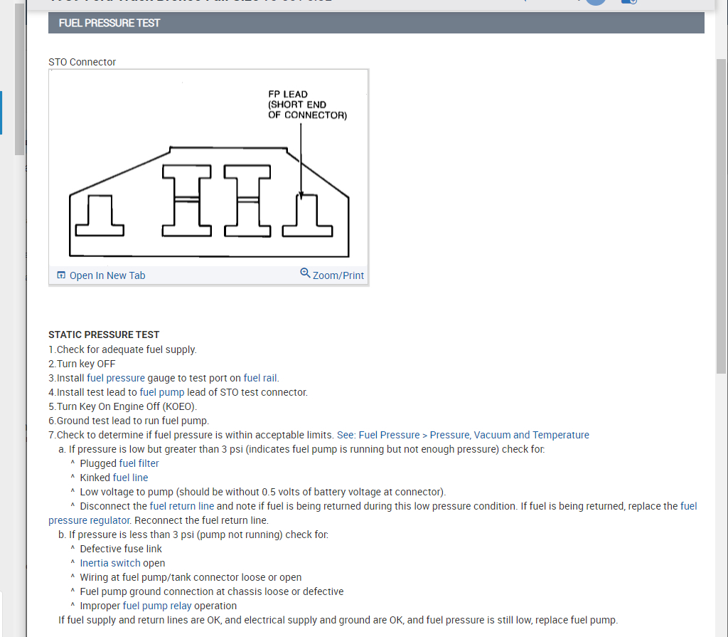

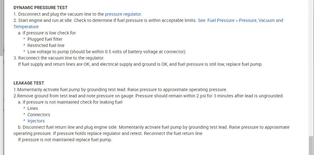

Let's start with checking the pressure to find out what it currently is because even though you have new parts on the vehicle we don't know what the current pressure is.
I attached the info below from the manual that will help with testing the pressure.
Once we know if it is low, we will need to check the filter to find out if it is restricted.
Please run through this info and let us know what you find. Thanks
