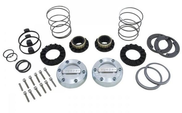

BANEFIZZ
Most of my questions have been answered by reading above, but a plain simple answer to this would help a lot.
Background: Bought an 87 F-150 4x4 truck with manual Trans and man locking hubs. Its a project. Drove it onto the trailer to haul home as the steering was messed up. Imagine my surprise when tearing down the front end to install a 4" lift and working on the front axle i find that all but the bearings are gone in both front hubs.
Can anyone give me a parts list and maybe the part description to complete the hubs so i can finally put this sucker on the road.
Have spindles, rotors/brakes and the drive shafts work, it will drive(rear wheel only), but nothing to actually connect said shafts to the hubs. In other words i need all the greasy innards that make the wheels drive. Sorry i cant explain better, hopefully i am making this clearer than mud as to what i need.
Jan 22, 2020 at 6:18 PM
STEVE W.
  • 15,113 POSTS
Sounds like someone removed the hubs because they were rusted or stuck. The easiest solution is to just go to a parts store or online and buy a replacement hub kit. It will come with all the missing parts you need. You normally buy the kit because then you have all matched parts because they don't sell the individual pieces.
