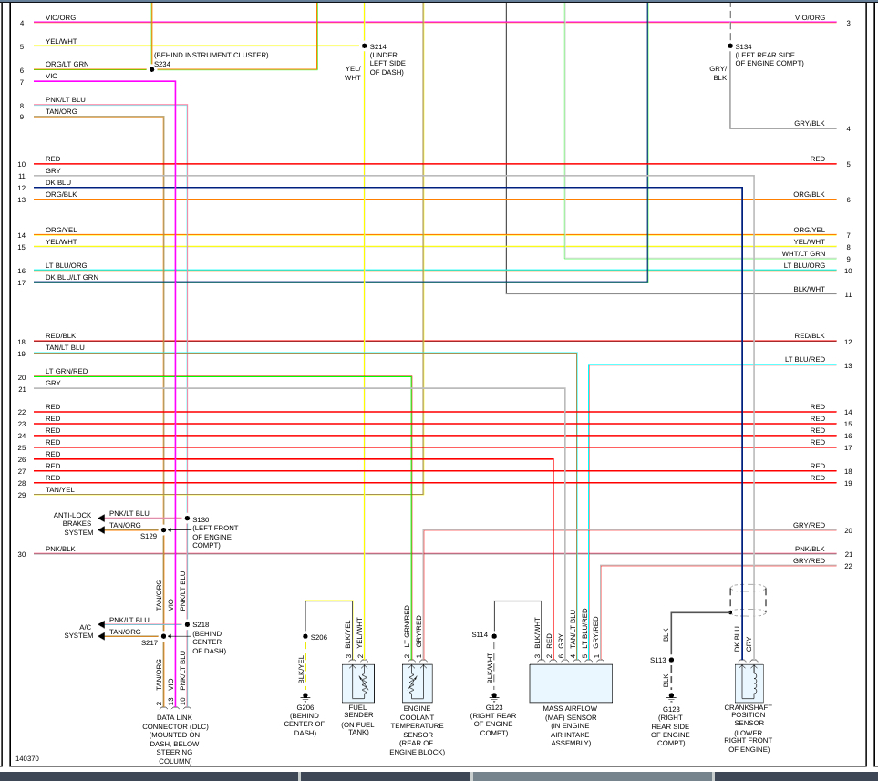

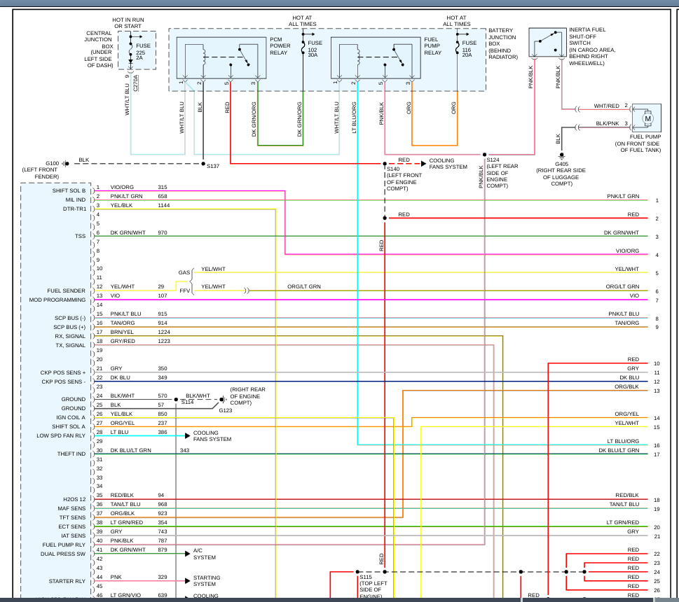

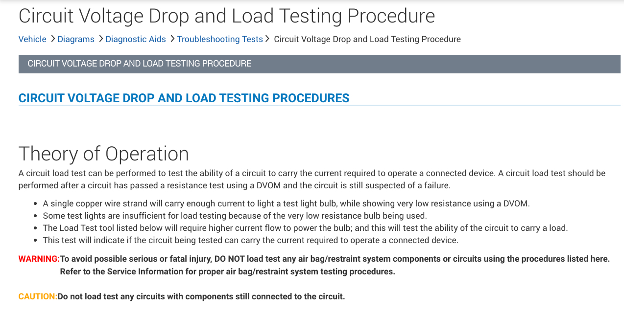

This guide can help us fix it which should make the codes go away
https://www.2carpros.com/articles/stall-at-idle

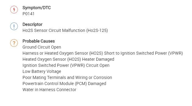

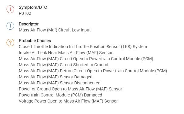

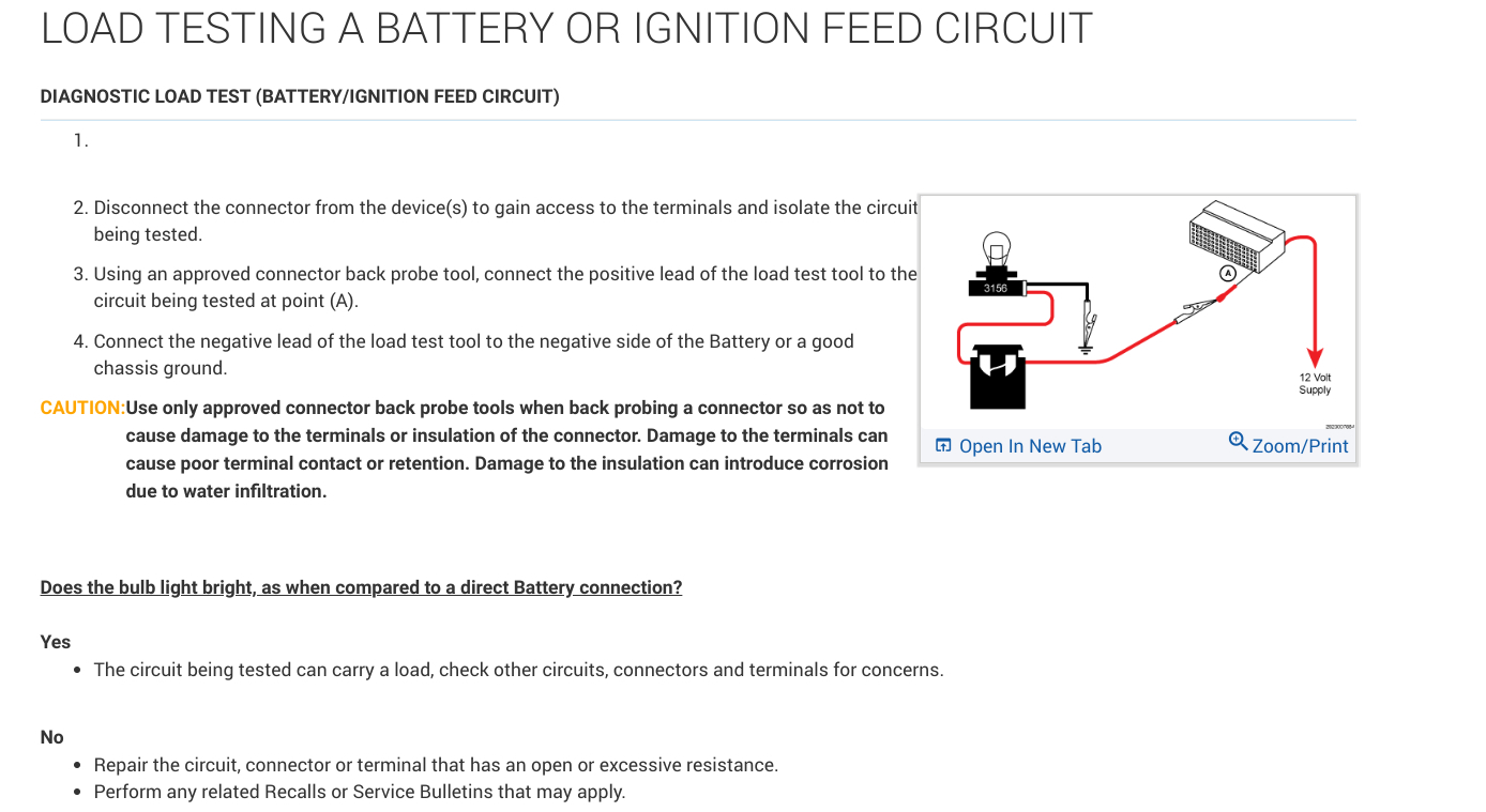

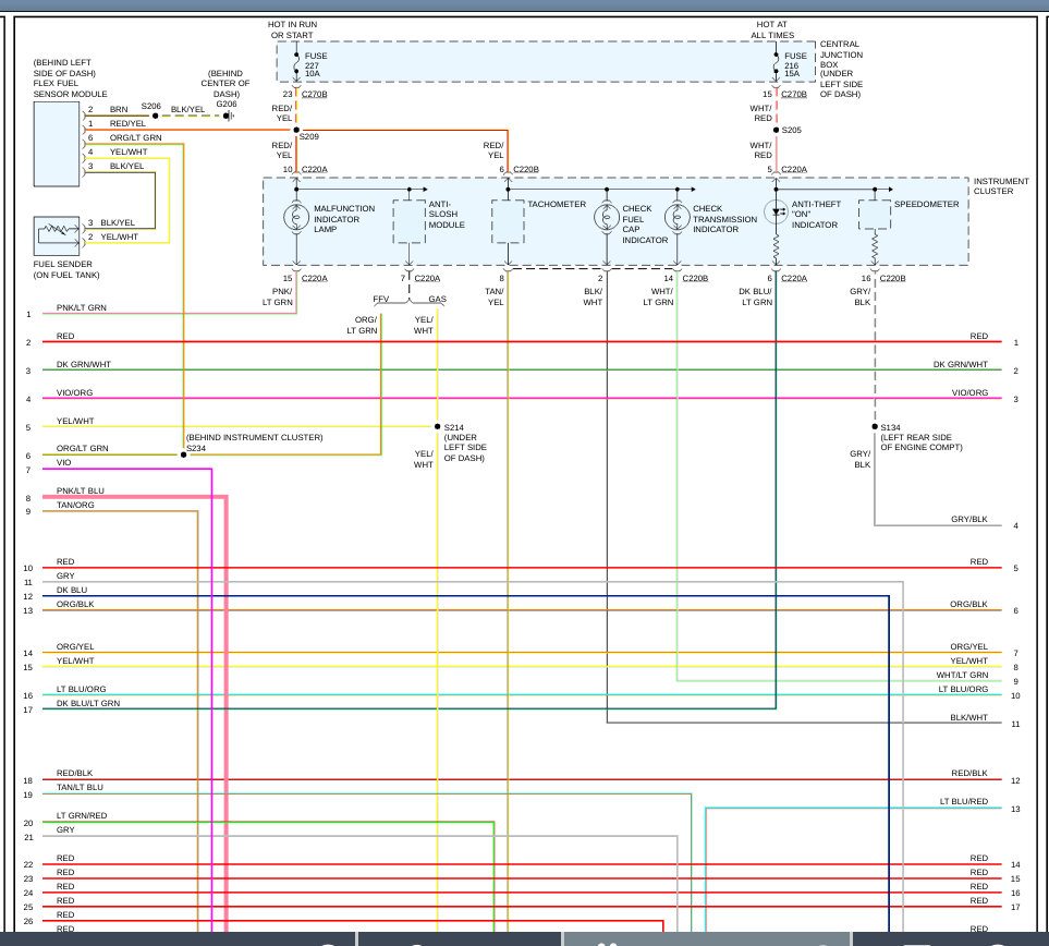

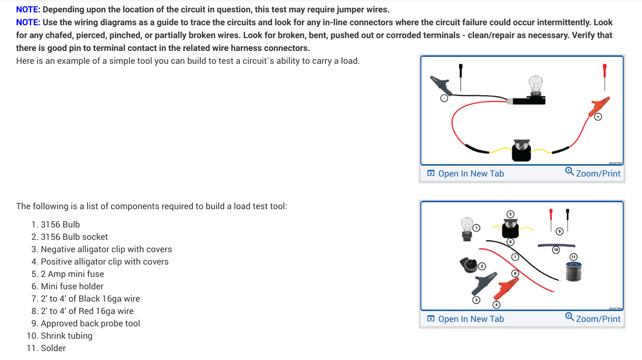

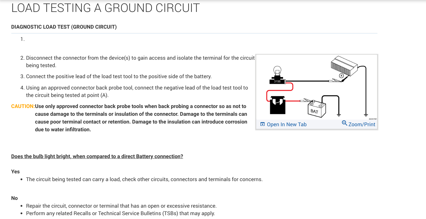

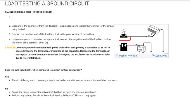

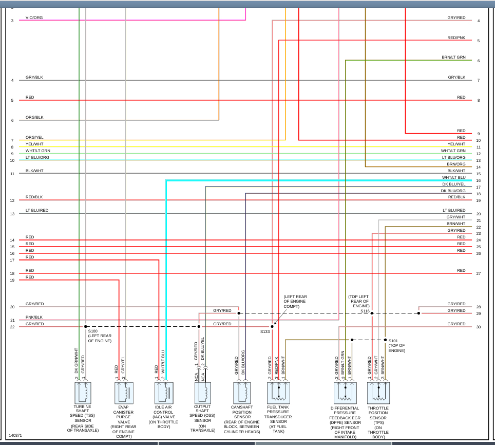

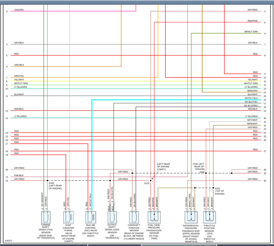

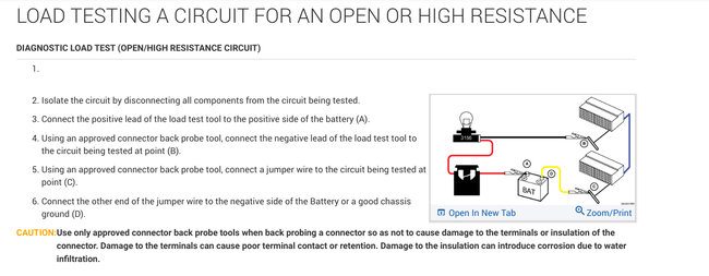

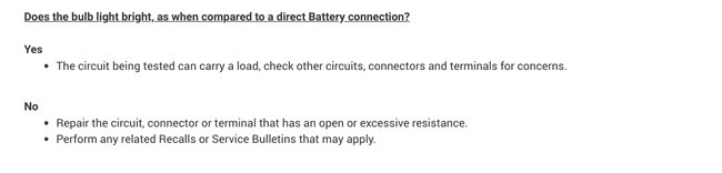

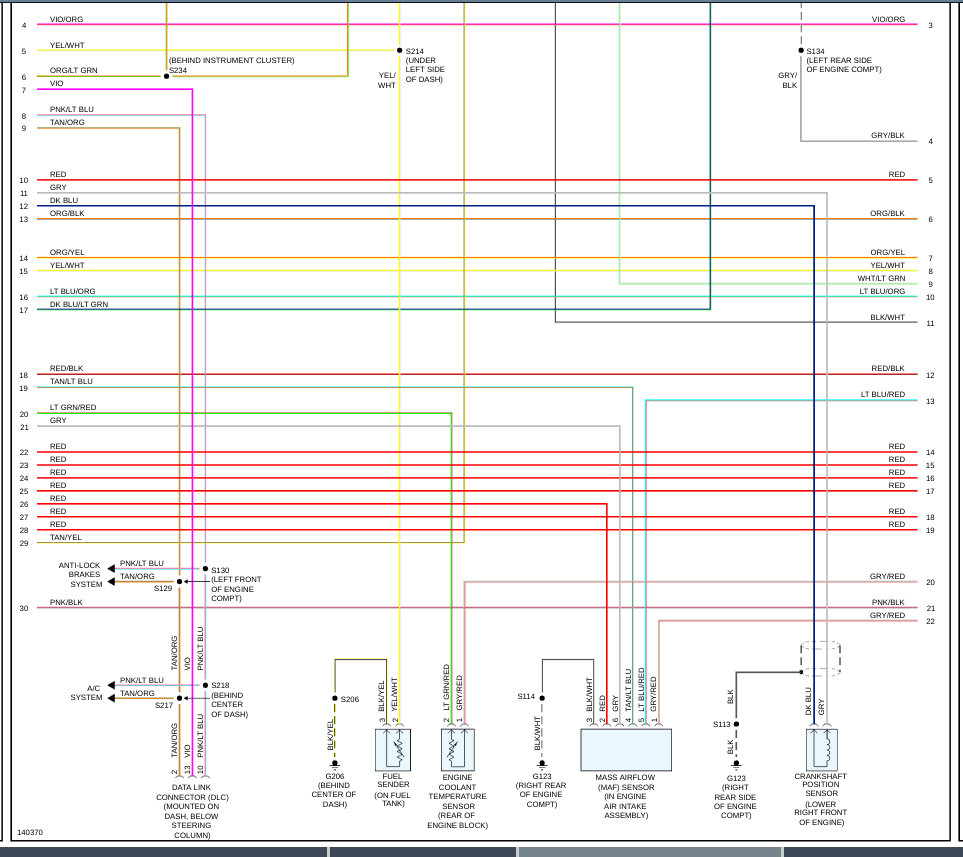

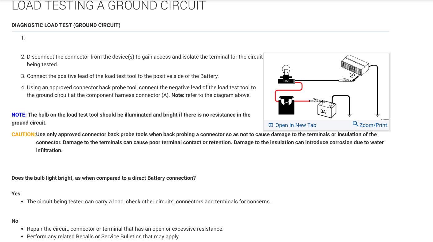

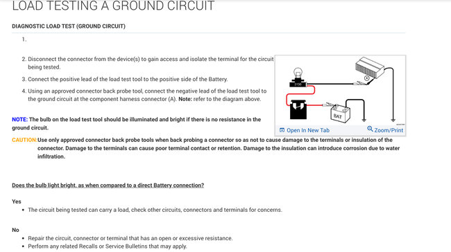

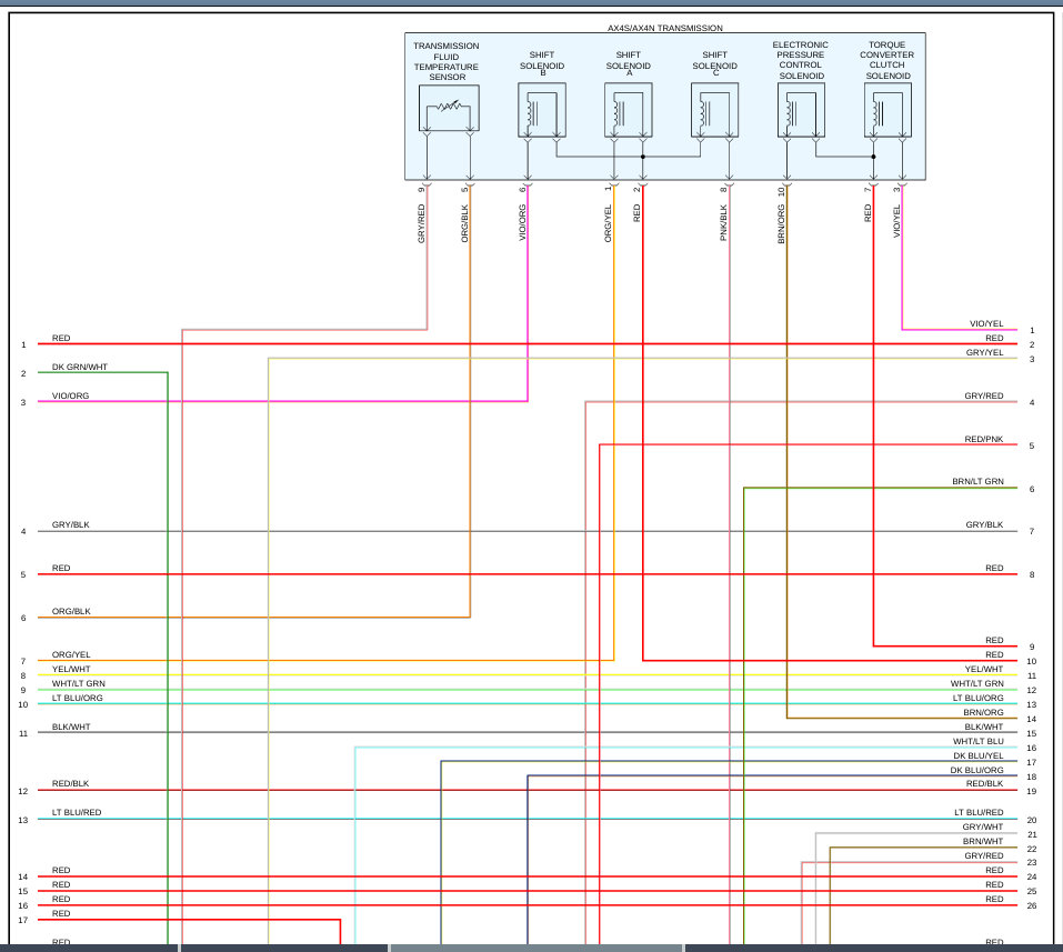

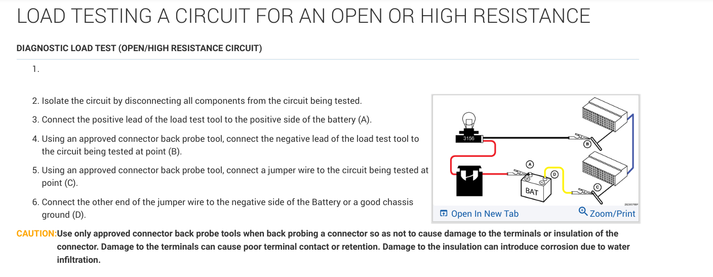

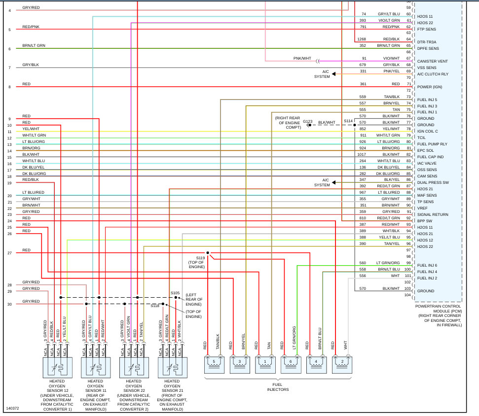

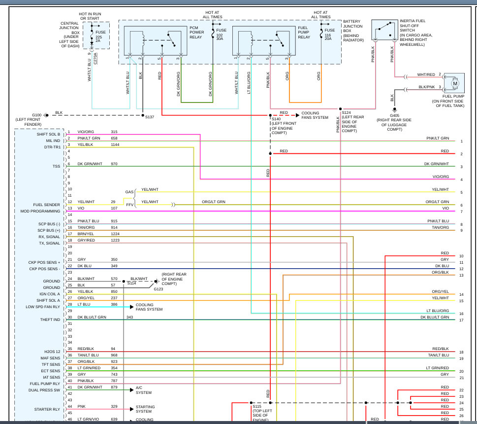

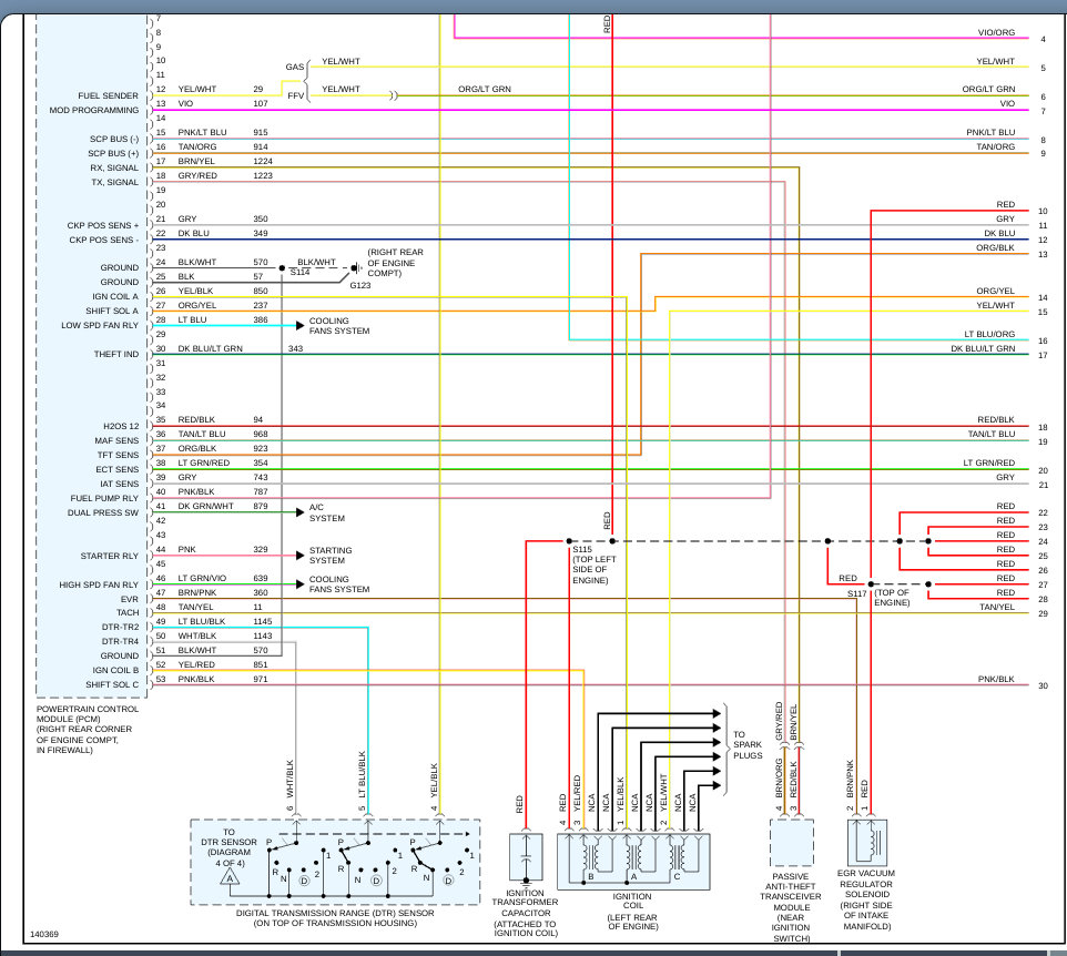

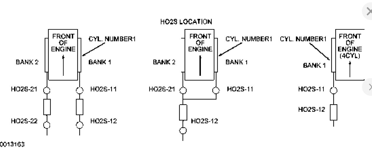

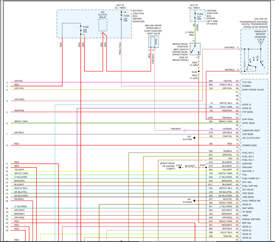

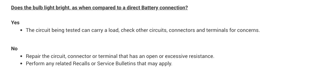

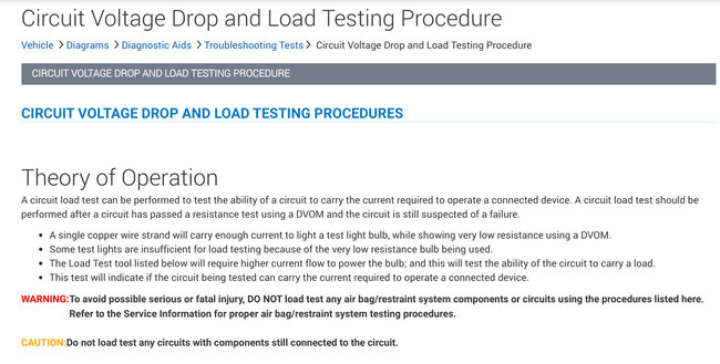

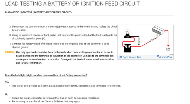

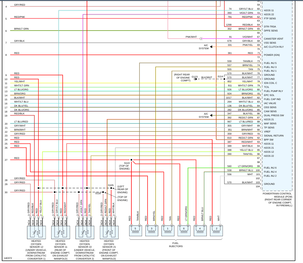

In the diagrams down below I have included the definition and possible causes for Direct Trouble Codes[DTC][s] P0102, P0141, P0171, P0174, and P1309. DTCs P0302, P0303, P0304, and P0305 are DTC's for misfires with the last number representing the cylinder number. So DTC P0302 is a misfire in cylinder 2, P0303 is a misfire in cylinder 3, and so on. I have also included guides for finding intermittent conditions, finding opens, finding short to grounds, finding unwanted resistance with voltage drop, and the engine management wiring diagrams for your vehicle. You will need to use a Digital Multi-meter [DMM] to go through these guides, so here is a link below explaining how to use one, if needed:
Please go through these guides and get back to us with what you find out.
