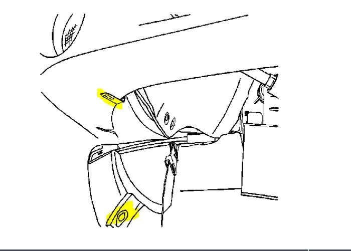

To gain access, partially remove the front edge of the front fender liner to gain access to the fog lamps. Take a look at picture 1 and let me know if it helps.

This picture is not familiar to me. There is a horizontal cover under the car with some nuts holding on. I was going to undo these nuts to see what's underneath. Just wondered I can access the fog lamp bulbs from under the car. The video shows removing the main head lights to access the fog lights. It's not clear to me. Thanks.

Thanks again. Perhaps the diagram is correct but I'm having trouble matching it to the
underside of the car.
